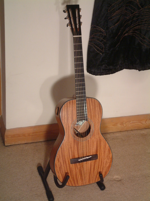

Ok here is the source of the sound - a Cuban mahogany parlour/Concert/O sized 12 fret body join. This was a fun comission as my very first comission four years ago was the same guitar.
Specs:
Top/back/sides/neck are figured Cuban mahogany, plantation grown in Micronesia. The neck is from the same block as the sides. The binding is ebony with bwb top/back and side purfling, ebony end graft, heel block and ebony venner on the front and back of the headstock. The bridge is Old Rio rosewood with split bone saddle and ebony bridge-pins. Scale length is 624mm (24.57"), lower bout width 335mm (13.19"), upper bout width 240mm (9.45"), waist width 205mm (8.07") and maximum body depth 95mm (3.74"). Tuners are Waverly's with ebony knobs. The finish is hand rubbed pre-catalysed lacquer over Z-poxy on the body and tru-oil over Z-poxy on the neck:

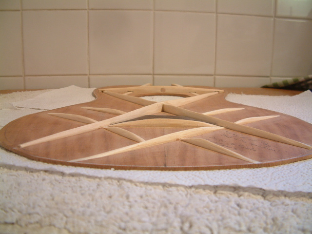

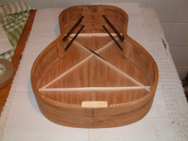

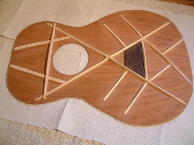

Bracing is my usual "triabolic" with hybrid X braced back with cf flying buttress braces:

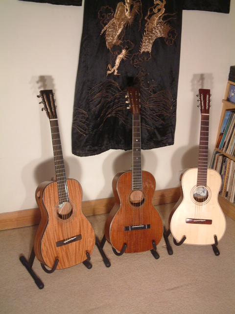

Here's the family - the original old boy in the middle, with the ladder braced version "Jack the Lad" on the right:

Very nice Dave, sounds as good as it looks too. I didn't post a guess as I remembered you saying you were building an all Cuban.

She's a beauty Dave and I really love the bracing - very clean, minimal, and resonate looking to me.
This guitar also has what I call a "best friend" quality to it in as much as it just looks like the kind of guitar that one would always wish to pick-up and relax with.
Do you know what it weighs?
I did guess the back and side woods correctly at being Cuban Mahogany.
Outstanding guitar Dave but that is never a surprise from you mon.

Your thoughts on the comparison between the two cuban guitars? (If you can factor in the difference in age, and--am I right?--no sound port on the older model?)
Fine looking trio there.

Sounds like an advanced system. I've been using either my "hyperbolic" (you can't say enough good things about it) or my "diabolic" (the baddest system there is).

I may be confusing you with the picture of 3 guitars above. The Old Boy in the middle is mahogany (not sure which sort) and 80+ years old. He sounds fabulous but has to be played with a slide. He really growls. As for the first Toby I made, it was X braced as well but more Lowden shape to the brace profile and much heavier bracing. He sounded good but I suspect this one is better out of the blocks. As I said to Colin I might get to A/B them next week so I'll let you know.

Dave is the top .125-.130 and even in thickness?
Do you think it would be possible to lighten the neck block and buttress anchors without compromising their structural integrity?

I also put bigger arches in my tops than most other makers, as I really think that this makes the tops "alive" and gives great volume and projection - I think of them as drum-heads and a sytem under tension that reacts when disturbed by the strings. It also helps the mids, but you can get a slightly "nasal" sound which dininishes as the guitars open up but I am still working on the bracing profiles to minimise this.

Structurally you can certainly have a much smaller neck block with the butress brace/free flaoting neck system and builders like Rick Turner and Mike Doolin use much smaller ones than I do. As for the upper bout, it's not a case of having no bracing but having bracing that lets the whole of the top move to produce the sound that you are aiming for. I still use small A frame braces on either side of the soundhole re-enforcement that tie in to the neck-block, but this is for the soundhole area integrity. Also I have an upper transverse brace that arches the top area, as when this brace goes on the tap tone of the whole top becomes incredibly "alive". However this brace is shaped for the top's sound rather than structural integrity.
