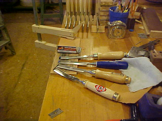

Slicing a four inch by 12 inch slab of leather from the cowhide, I clamped it to my workbench via a Klemmsia. Then I pulled out the Dico White Rouge picked up at my local Ace Hardware. You have to peel back the paper and it is similar to a big one inch crayon in a tube, about six inches long.
I rubbed the rouge on the leather, just kind of smeared it on two inches wide and about six inches long on the smooth side of the leather. Strokes of the chisel must be along it's length toward the cutting edge. Flat side first, then flip and do the angled bevel of the chisel.
In only a few minutes it was perfect and would shave hairs from your arm. All you had to do is touch it with your fingertip and you knew it was sharp. It easily sliced into the leather if you happened to slip sideways.

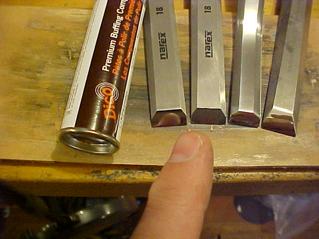

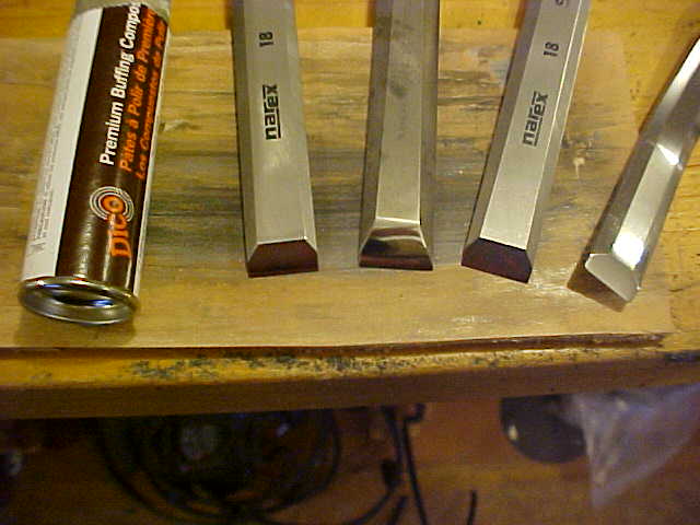

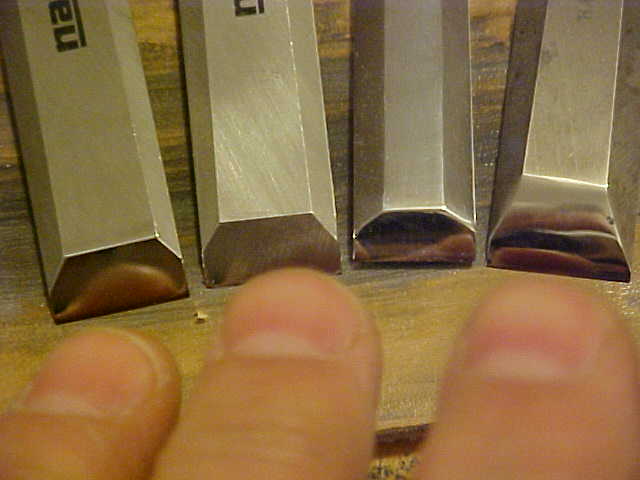

This picture clearly shows the sharp by the shine. Notice the two Narex Chech chisels on the left. One reflects, one does not. The second from the left is the unsharpened one, the other three all show degrees of shine indicating their sharpeness. You would not believe the difference.

JJ, I don't have a clue what the angle is on the chisels? All I can tell you is they are sharp as razor blades and cut spruce like butter. Removing factory cross-hatch manufacturing lines takes a while, but when they are gone, these babies will cut and have the mirror finish folks rave about.
