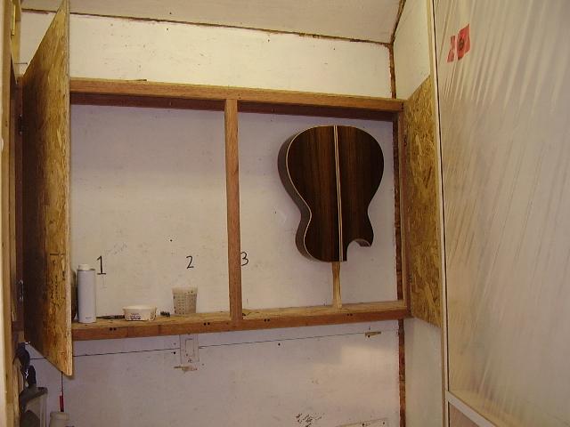

When I do my wet sanding, I use mineral spirits. No water/soap here. I dry sand to 800 3M gold no-load papers (if I had a buffing wheel, I'd just start to buff after this) than wet sand with the mineral spirits to 2000 than OOOO steel wool with paste wax, gives a semi gloss finish that I like.
I think to solve your gnat problem, you need to have a dedicated booth of some sort first off to contain the fumes of the over spray and than to keep the gnats out. Also think about building a cabinet that you put your bodies and necks in after you've sprayed, kind of like this
This cabinet of mine can hold two guitar bodies and two necks. Mine isn't sealed off from the rest of the booth but I don't have gnats.
