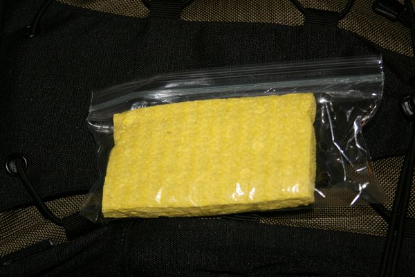

Kitchen sponge, really. Just purchase a box of ziploc "Snak Pak" bags...they're really small, like 6.5 x 3.25, something like that. Then get the basic kitchen sponges...which are something like 3 x 5.
With one of those school hole punchers, punch a bunch of holes in the snak pak, making sure to stay inside the perimiter by 3/4" or so.

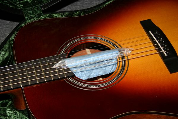

Wet sponge thoroughly and ring out hard, by hand. Insert into pak and zip. Place sponge between the D and G strings low enough to get the sponge deep into the soundhole.
You can make a bunch for just a few dollars. They work great, and when the bag wears out (which will take a year or so), make another one.
