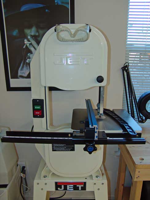

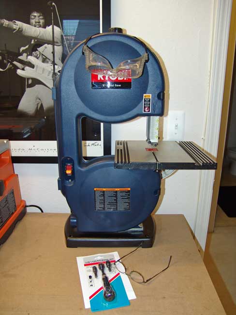

One of the things that I do now is keep safety glasses (AND wear them) near or on every tool that I should be using them with.  I actually try to put the glasses in a place that I have to touch them to use the tool.

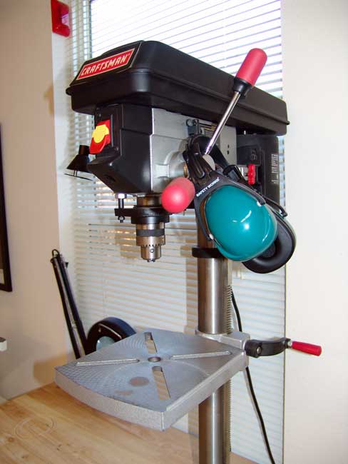

And although hearing protection is generally not needed for using a drill press this makes a handy place to hang these things.  I do use hearing protection when ever there will be a sustained high level of noise like when using a thickness sander with the vac on or the belt sander with the vac on.

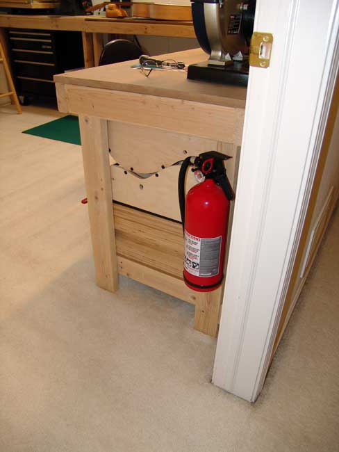

And Pat suggested to me a couple of years ago that I needed a fire extinguisher, fully charged.  Prior to this suggestion it just never had occurred to me in my rush to build guitars.  I figured that placing it at the door to my shop would give me options.
