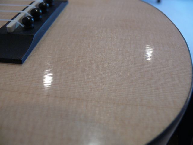

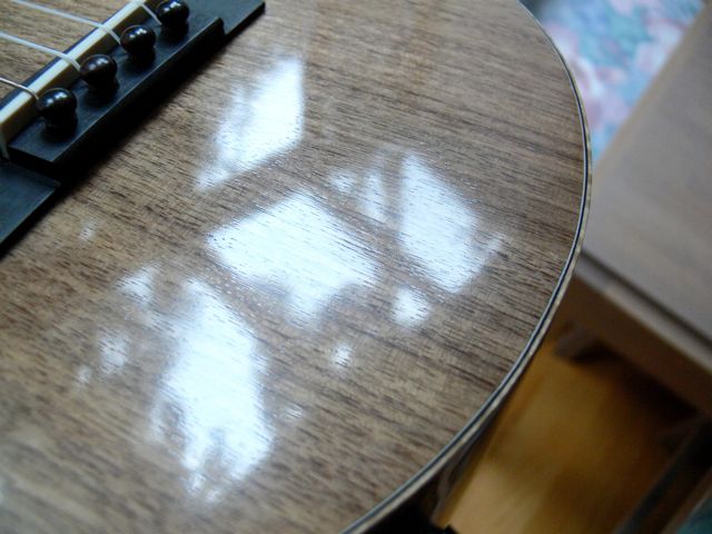

PostPosted: Tue Dec 18, 2007 9:04 am
Posts: 1012
Heres a couple of pics that illustrate the problem I see with Colortone. IN the first photo, it appears that shrinkage on the spruce top has created small ridge lines.  This instrument was finished some two months ago.  The second photo is walnut on an instrument finished 6 months ago.  It looks like the pores opened - like they had never been filled.  Neither of these instruments exhibited these problems just after they were finished, but appeared about a month after.  I don't have facilities for spraying nitro, so only other alternative is french polish.
A higher purpose for wood.
Rich Smith
Issaquah, WA

What was your finishing schedule like on the guitars you showed in the pics?  how was the wood prepped? what product was used? how many coats? what type of sealer, if any?
PostPosted: Wed Dec 19, 2007 9:20 am
Posts: 1012
I pretty much followed the schedule published on stewmac's site.  I used Colortone grain filler (which is not very effective), Colortone sealer (at least 12 coats) followed up with Colortone top coat lacquer (12 coats).  I waited a week before polishing.
