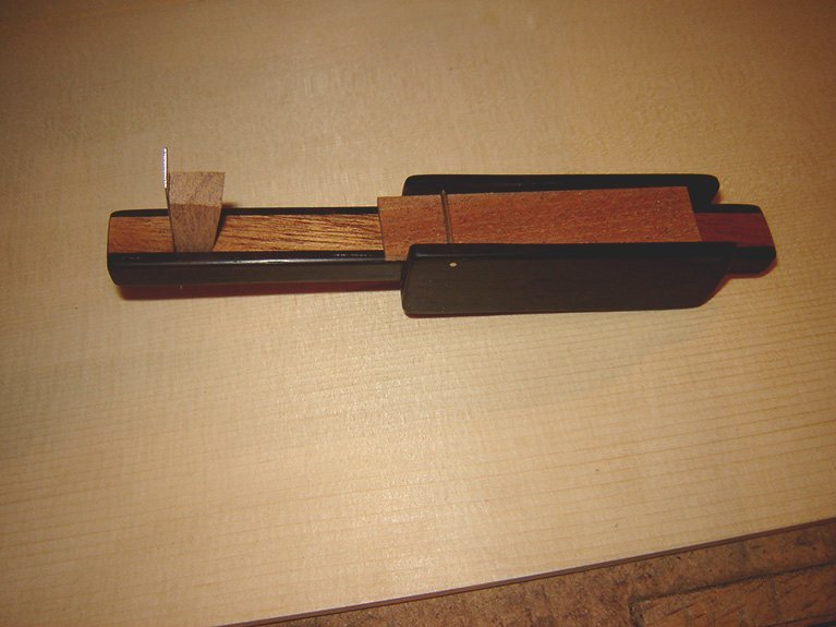

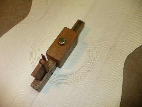

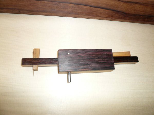

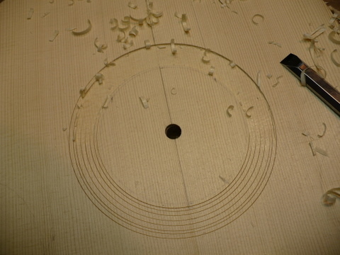

If I could've voted for two methods I'd also have voted for 'by hand with chisel'. In fact the last rosette channel I cut I did with a scalpel blade mounted in a home made cutter (design stolen from Joshua) and chiselled out the trench. It was just as quick and just as accurate as using the power tools, and a lot more satisfying.
The cutter is made from BRW and cherry scrap, and works like a dream, it guarantees no fuzzy or damaged edges. In the future I will always define the edges of the trench with this tool and just remove the waste with the Dremel.

I use my circle cutter and a chisel.
It was pretty quick, considering my level of experience.  Probably took mme an hour, maybe a little over.

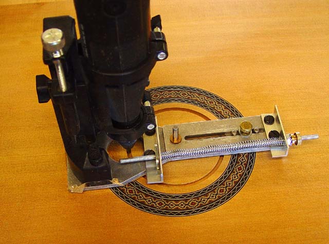

I use the stew-mac circle jig with a dremel and downcut bits.
PostPosted: Tue Dec 18, 2007 3:42 am
Posts: 140
I modified the old style Stew-Mac jig for the Dremel tool by adding a spring. This allows for very fine adjustment with no back-lash.

Colin, do you have any other photos of the other sides of this sweet tool for anyone else to "borrow" that design? It looks pretty slick. Thanks.
-j.

J, this is a shot of the top of the cutter. I found that using scalpel blades with a rounded cutting surface was better than the triangular blades.
I now have two of these so that I can have blades orientated with the bevel in opposite directions for the inside and outside of the circle. A bit over the top perhaps!
