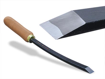

I have really been on the fence about whether or not to buy one of these high priced glue removing tools.
I finally caved and bought one.
This thing simply put, ROCKS!

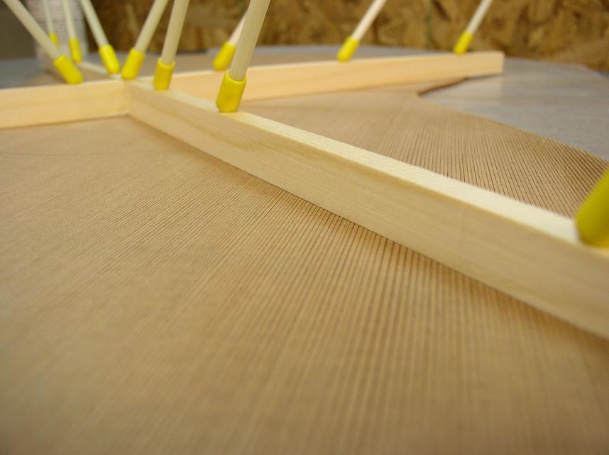

Here is a close up of a brace to redwood joint.
It makes a nice tight fit between the brace and the plate and does a great job!
I am very picky about the inside of my stuff and I honestly feel this will help me to do a better job.
I would highly recomend this tool to any builder at any level.

it is a great chisel. I have had one for years and it works great. Recently,
because I'm a tool whore, I got three of these. They work equally as well for
about half the price...
http://www.diefenbacher.com/Special%20Chisels.htm#Curved%20P aring%20
Chisels

They are great for tapering and scalloping braces, too!

Lance don't even try to pass that photo off as real...we know there's no glue under that brace. You just stuck those bars on there to make it look like it.
You are the King of Clean, no doubt.

John, are you referring to the curved chisels only? Thanks.

Okay, now that you've taken the picture dry, let's see it again after you glue it.
You know, kind of a before and after photo comparison!

Well I have a full set of the std bench chisels too, but for this discussion,
yes the curved chisels. The 16mm is my favorite.

Stew mac sells a chisels that looks like this but they sell theirs as brace carving chisel. Is this the same thing? If not whats the difference. Just wondering. By the way Lance that is one clean top.
PostPosted: Sat Dec 15, 2007 5:59 pm
I love mine too--bought it several years ago--how do you plan to sharpen yours?

I've tried it. It sorta works. If you don't care about getting it really clean
it works. If you really care about getting all the squeezeout, and it's
residue so that your braces look like they are just laying together....like
lances photo. then that technique does not work. Take a close look
inside a Taylor. They are fine guitas, but not totally pristine...they can't
afford to be making hundreds a day.

The LMI glue clearing chisel was one of the very few tools that when I started building guitars I purchased correctly.   Most of what I bought in advance of learning to build ended up being either junk or useless for how I build.
This is a great chisel.
Scott I sharpen mine on wet stones, not in a guide, by hand taking care to use my fingers to keep things lined up.  It works fine for me.

If you work your braces, clean them up, etc, in a dish as I do AND if you use HHG or any glue that dries very hard take great care to vacuum your top and dish frequently.
This chisel will pop large or small very hard chunks of glue off and these can get stuck between the bottom side of the top and the dish.  This may dent your top.

I was taught by Sylvan Wells to use them for brace shaving also, especially
taking the ends down to zero. Much more comfortable tool to work with
than a straight chisel.

I may have missed the post, but what make (brand) is the chisel you bought?

Randy,
Its from LMI
You can find it Here
