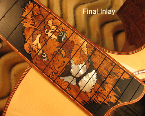

Hey, Kevin, the Pic size is bumped up to 500 K now. This lion is 105KB.

Bruce,  Did you do this inlay?
PostPosted: Wed Dec 19, 2007 8:50 am
Posts: 1041
Dave,
   That's the Lion of Judah inlay that I did on the guitar that I took to Africa.
We have a potential buyer for it now and the proceeds will go back to Africa
when it sells.
   It was built a little heavy with the trip in mind and suffered some finish
damage whil there in Kenya. It plays great and sounds good, but i'm going
to give it some attention before it leaves my shop to loosen it up a little.
Regards,
Kevin Gallagher

What Kevin Said Dave....
Pretty nice eh?
