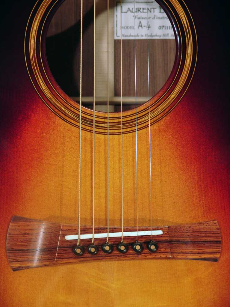

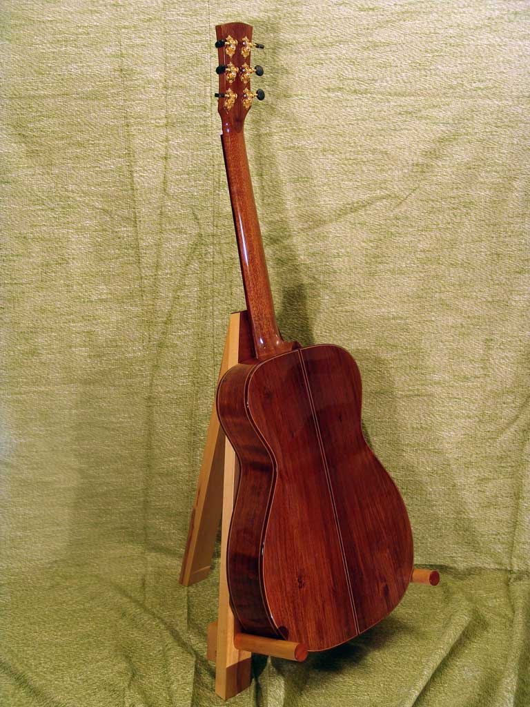

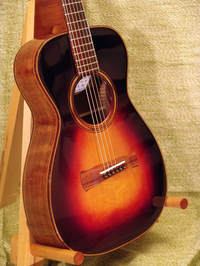

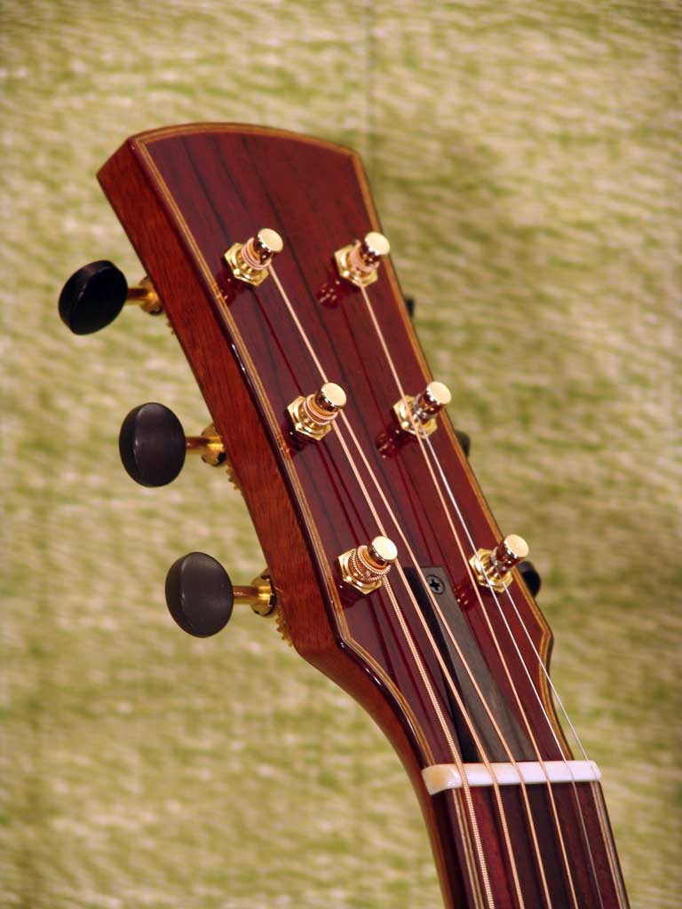

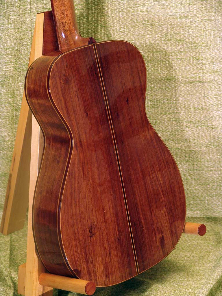

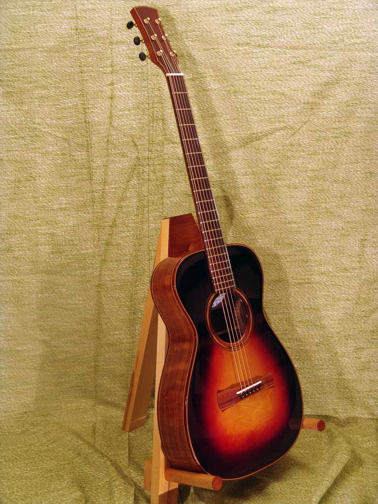

Hello folks, it's been a while, I've been busy, I'll try to post pics of guitars I completed last month in the next few days. Here's one, it's my take on the Martin 14 fret 0 shape, 13 1/4" lower bout, 25" scale, cocobolo trim, fretboard, bridge and peghead veneer, custom rosette (that's my theme for 2007), oil varnish. Thanks for looking!

That's a sweet little guitar. I like the all wood and wood combinations you have put together - very elegant indeed. Very nice rosette and I like the bridge contours as well. The varnish makes the woods look very tactile - well done! Was the bracing design your own or from a plan?
The usual question - how does it sound?

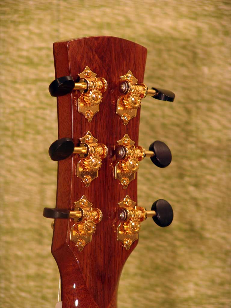

That is really beautiful! The rosette is great, are all the purfling lines the same wood? Is it maple? Where did you get the tuners also? Is the oil varnish on the top too? That is a lot of questions. I really like it!

Your latest is gorgeous in all respects.  From the excellent finish with a beautiful burst to the rosette that I would like to know more about please?
And - how do you like the tone with Honduran Rosewood?

I tried really hard, but there is nothing there not to like.  Beautiful in every way, even the burst.  Like Dave, how does she sound?

[QUOTE=Dave White]Was the bracing design your own or from a plan? The usual question - how does it sound?[/QUOTE]
Bracing is mine, nothing revolutionary, two x-braces (with a narrower angle than Martin's I believe), one tone-bar, four finger-braces. I use a "doughnut" to reinforce the soundhole area and also my soundhole braces are mortised under a fairly large upper-brace (5/8"), the latter meeting the neck-block tongue running under the FB. The sound is surprising for such a small body, it's not lacking is bass, although the mids are strong, pretty rich and clear and enormous projection. I'll record a sample when I have time.
[QUOTE=blegeyt]Where did you get the tuners also? Is the oil varnish on the top too?[/QUOTE]
Tuners are Gotoh Sta-tites imitations/re-issues, they're very good IMHO. I just replace the buttons with ebony ones as sold by StewMac. Sunburst was done with nitro-cellulose lacquer, top coat is oil varnish though.
[QUOTE=Hesh]From the excellent finish with a beautiful burst to the rosette that I would like to know more about please?And - how do you like the tone with Honduran Rosewood?[/QUOTE]
I made the rosette material with 2" x 5" (it could be any dimenson though) stacks of alternating .020" curly maple and .080" various hardwoods (mahogany, koa, rosewoods etc.). I glued the stacks together in a staircase configuraion until I had about 32" of length. Then I planned/sanded down the long staircase flat to about .040" thickness. After that I ripped strips on the bandsaw and cleaned them to .080" height for side purflings. For the rosette I cut one strip in two, invert one side and put a .010", 015" 0r .020" curly male between and build my rosette with other wood strips around. I hope it's kind of clear… It's sort of the traditionna Spanish way to make herringbone, no? I like Honduran RW a lot, it's heavy though, but tonally in the same territory as Braz, cocobolo, bloodwood, pau rosa etc. It definitely favors the bass and allows overtones to go through without losing clarity. But the top is German, very lightly braced and pretty thin so…

Very Very Nice! I love those rich warm colors and tones!!!
Excellent effort, and a beautiful body style..cool rosette, nice bridge, simple headstock design but very tasteful and love the binding/purfling scheme.

Fantastic! I love the appointments, and the overall color scheme. That thing is Warm with a capital W.
