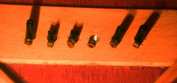

Here's a 1935 Martin that came in last week. Solid pins originally, and though only four originals were left the owner had the sense to put the slotted replacements in backward.
72 year old guitar, and the maple is slightly compressed. If you can find a guitar half that old with slotted pins that isn't either ravaged or already repaired, you're lucky. You just never see those problems though with traditional solid pins, unless of course someone has replaced the pins with slotted ones which is a double whammy.
You may also note the fourth pin in the above photo is missing. This is testimony to how the strings hold in place well enough with the pins removed. They hold so well in fact, that the owner apparently thought they could substitute one of their pins for an impromptu endpin. Looks like it went in a bit too far though.

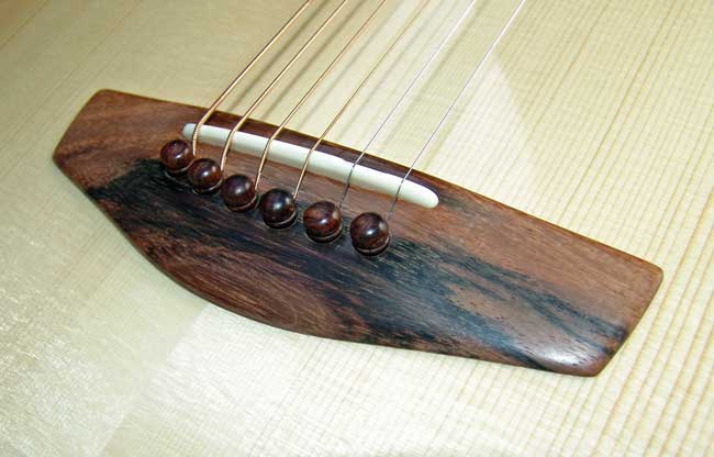

J also Louis (OLF screen name Louis4052) will make you custom pins out of the material of your choice.
Louis made these beautiful BRW "stumpwood......" 3 degree, unslotted pins for me.

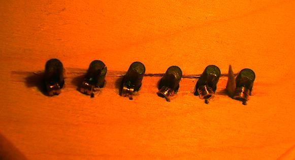

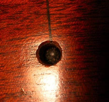

I said I would post some damaged bridge plate photos when the next one came in, so here goes. This may not be the best example, but not atypical either. Massive plywood 70's Gibson double-X bridge plate that came in this afternoon.
Someone had already slotted the bridge and plate, and whether they advised the customer or not to use the pins in reverse we'll never know. In any case, they didn't. Don't ask me where the toothpick comes in, I haven't a clue.
The bridge had already cracked along the pins once, and a previous repair tech had glued and filled the crack a couple years back. Unfortunately they paid no attention to the underlying cause, that being the ball ends pulling up through the plate. This went unattended to, and in just a couple years the symptom of the cracked bridge came back. Now it needs to be replaced, along with a proper bridge plate and top repair.
Here's a shot of the damaged pins, and a good view of the misguided slots in the top.
