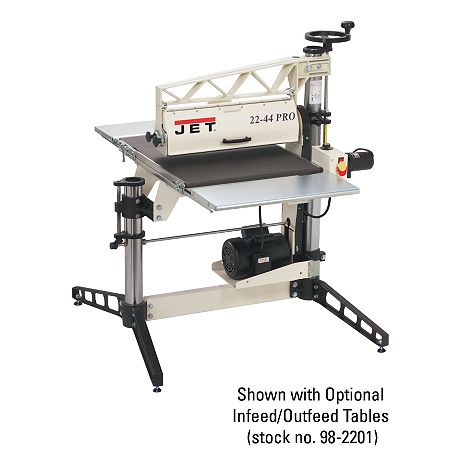

J., I'm talking about something that looks similar to this. I think the only requirement is that it can accept a 3 1/2" thick piece of material, because the jig is 3" tall(plus the fretboard thickness).
I watched a fretboard get radiused in 2 minutes, and it was perfect. If you use 220 grit, then when it comes off the machine, it is ready for fretting, or gluing the fretboard to the neck. This is while the fretboard is in the rectangle state and slots are already cut. But you could cut your taper too and use it just fine. The prototype is completed for a 12" radius, but before I have 20-50 of them made, I need to know what radius people need. I may have 2 different radius' made if there is enough interest in another radius. I was told that Taylor uses 12" radius, and Martin uses 16" radius. So I may just offer these 2 for now.

Tracy, according to the manufacturer's specs, the performax 16-32, which I think a LOT of people here on the forum have, will only go up to 3". I'll double check the reality of that at home maybe tonight.

Thanks for answering this Poll guys. I'm working with a local builder here who designed the jig, and he uses a 12" radius. But I'll see about having parts made for 12/14/16/20 inch radius'. It is only really 4 parts that need to change between each jig. They are all being cut on a CNC machine.
J., your comment "so any drum sander will work as long as it fits your jig height plus the FB." is correct. If you have a wide belt sander with a 4" opening, you will be fine.

J.,
I just looked it up, and your right, the max thickness is 3". Looks like we will need to adjust this jig to accomodate all you performax users!

Thanks Tracy I checked my Performax 10-20 and it has a 3" height limit too.

To borrow an O'Brien term: The clearance is just a "skoshe" over 3", so if any modification could be made for us performax/jet guys, it would be much appreciated.

Looks like the jig can be modified to accomodate about 2.75" clearance w/
the fretboard, so it should work just fine with a belt sander that has a 3"
clearance. Thanks for all the help everyone! Hopefully we will have this
tested and ready sometime in January.
