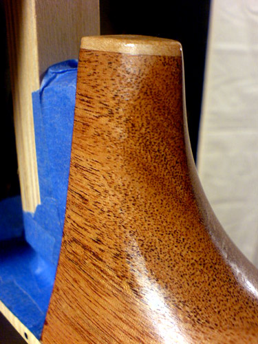

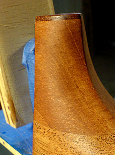

I've completed two coats of straight pore filler plus one coat of 50/50 epoxy/da, and am generally pleased with my progress, except... I've got some dark spots on the end grain of one heel, as pictured below:
I was pretty darn meticulous with my sanding and prep, and the other heel looks quite good:
Any suggestions as to how to deal with this? I don't really know how I could sand it any more thoroughly than I already have. Is it possible that these dark areas are inherent in the wood grain? If this is the case, might I just have to live with it? Thanks for any input.

It is my experience that it is in the wood. No matter what you would have used for pore filling, this wood would have darkened in some places. The one place that I notice darkening more than others has always been on the heel of the neck. Another place is the tip end of the headstock where there is also end grain exposed.
PostPosted: Tue Dec 18, 2007 5:28 pm
Posts: 13641
Location: Ann Arbor, Michigan
First name: Hesh
Last Name: Breakstone
City: Ann Arbor
Yep that is the wood Ken.
But you can do this:  Prior to finish sanding, next time, hit that area with a damp rag, let dry, and sand - repeat this process several times.
It raises the grain in that area and let's you even it out somewhat with the sanding.  This is a trick that stainers use to even out the appearance of the stain on end grain.  It works too.  Even though we typically don't stain our necks this raising or the grain and then leveling will even out the natural color somewhat, not completely mind you, but it will be an improvement.
Also, this is a look that I like so perhaps just appreciate it for what it is?  Your necks look great to me!

The dark areas of the heel look to me like excess epoxy. It may be as the others have said, just in the wood, but if it were my heel, I would sand it back to bare wood again and see if it goes away. Then a thinned coat of epoxy to even it up.

I'm tempted to agree with you Glen, though that's the only area on two necks and bodies that were affected. If anything, I tried to be more thorough with the heels because of the endgrain. I may try it anyway. It'd be well worth the effort if it works. If I did leave some epoxy behind, would it show up dark like that? I'm going to closely examine it and see if the dark areas cross over the glue line between the two pieces -- if so, it's definitely not in the wood. Thanks all!

When I get the excess epoxy blotches, it's usually the same color as the wood (from dust) or a shade darker. I always get them on the neck one place or the other and end up having to tweak with sandpaper and thinned coats of epoxy (sometimes more than once). The discoloration I see in your picture looks identical to my excess epoxy residue with the exception of the color. I agree, it does looks a little too dark for the wood of your neck.

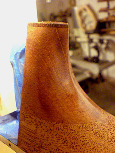

I couldn't stand the thought of leaving things be, always wondering if more sanding would have mitigated the problem, so I went ahead and sanded it back down, thinking the whole time it wasn't doing any good, since I could still see the dark spots on the sanded down wood. However, with a thinned coat of epoxy applied, lo and behold:
Much improved! There's still some slight darkening near the top in the picture, but overall, it's much better. The other side looks way better as well. Thanks to all for your input!
