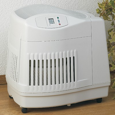

Rich my friend I run two humidifiers - a 12 gallon Sears w/digital display for the entire 1,400 square foot condo and a 10 gallon Sears w/digital display for the 126.5 square foot shop.  My shop door is always left open as well.
In Michigan in the winter with forced air heating it can get very dry and in the summer I have to dehumidify the shop.
Both of these units are in their third year of operation for me and they work very well.  I did have to learn to clean the filters, perhaps every 3-4 weeks, so that I was not constantly having to purchase new filters.  Thanks again to Bill for this!
And the digital displays are not accurate but they are accurate to themselves in that once you set "a number" that keeps your shop at the desired level, as indicated by outboard, calibrated, and multiple hygrometers, they maintain my place at very close to 45% RH.

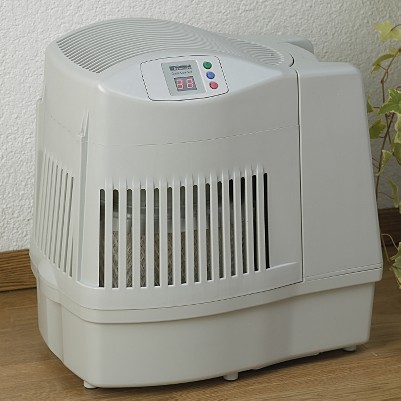

This one keep me happy. So quiet ya barely know it's there. Large enough that it only runs maybe 10-20% of the time... Change the filters once a year...
It can be plumbed for auto re-filling, too....
PostPosted: Fri Dec 28, 2007 5:49 am
Posts: 1667
grrrr. f*&#@ng edit button stupid missing phargling feature dumba$$  removed bull $^!)....
It's a Sears unit; search their site or your catalogs.. It's on sale right now, too.

I have one like Grumpy's, but have never changed the filters, 4 years.
The one in my shop however got to stinking recently.  Had to change out the rancid water, so keeping them clean is a good point or you'll sometimes begin growing stuff that stinks.
My big one came from Lowe's Home Improvement, but it's a kissing cousin to the one pictured above.

Rich, to pipe it directly, you'll need to go to a home center or hardware store, and get a separate kit. They're complete kits, which will include the line and floats and everything. It's similar to the kits they sell to plumb a fridge or ice maker.
May I suggest you also add an overflow and run a larger hose(like a garden hose) to a drain, if you have one nearby? Aways good to have a little assurance <g>.
Brad, sounds like you need to at least get yourself one of these large ones. You'd go at least 3-4 days between fillings, and you'd likely save enough on power usage to pay for it in a year or two.
