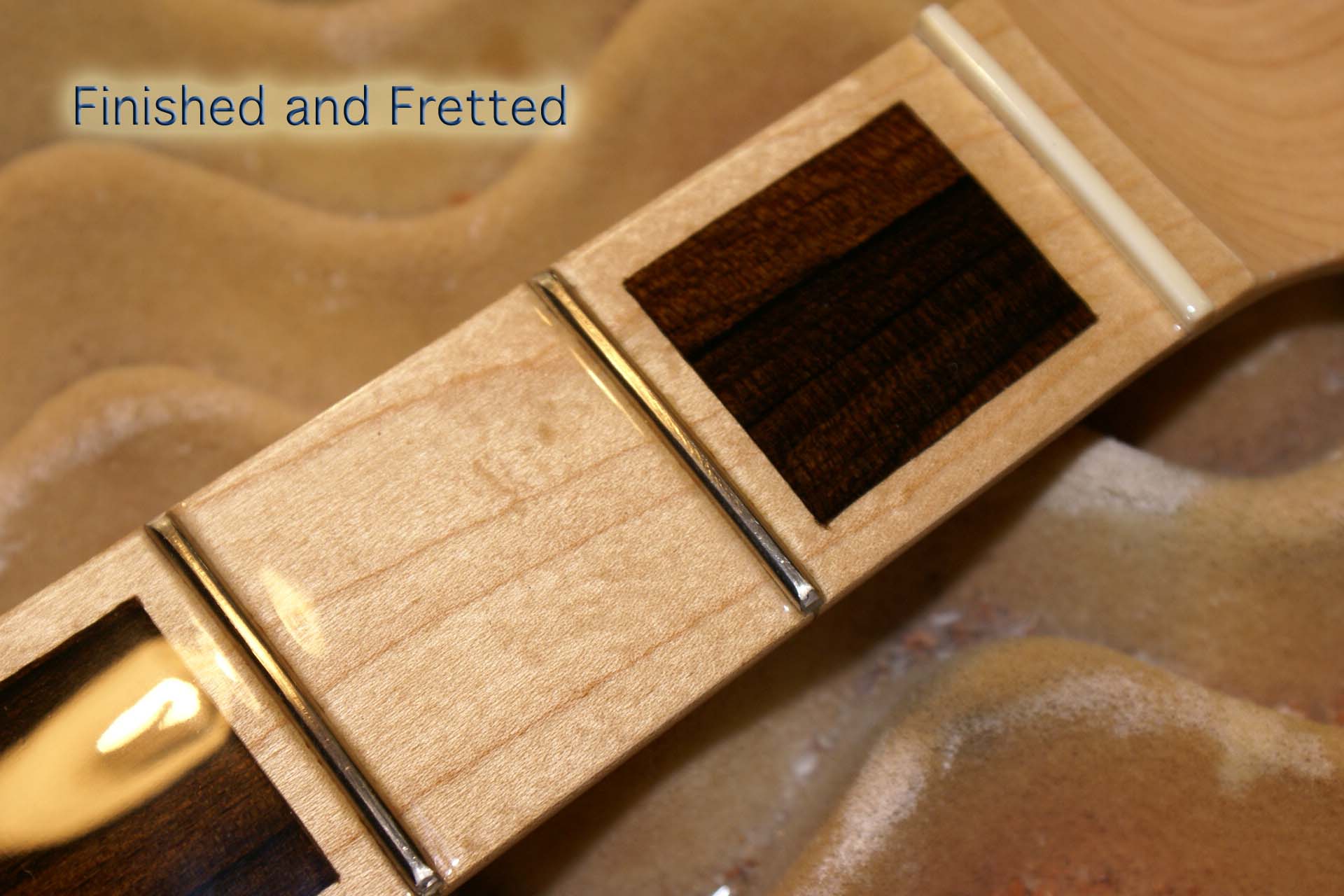

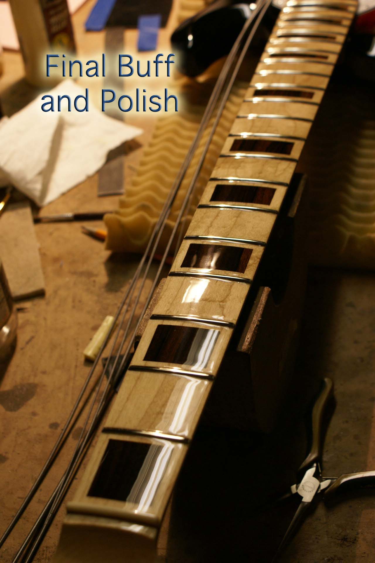

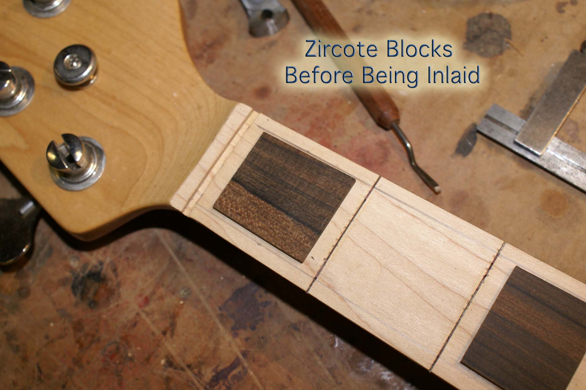

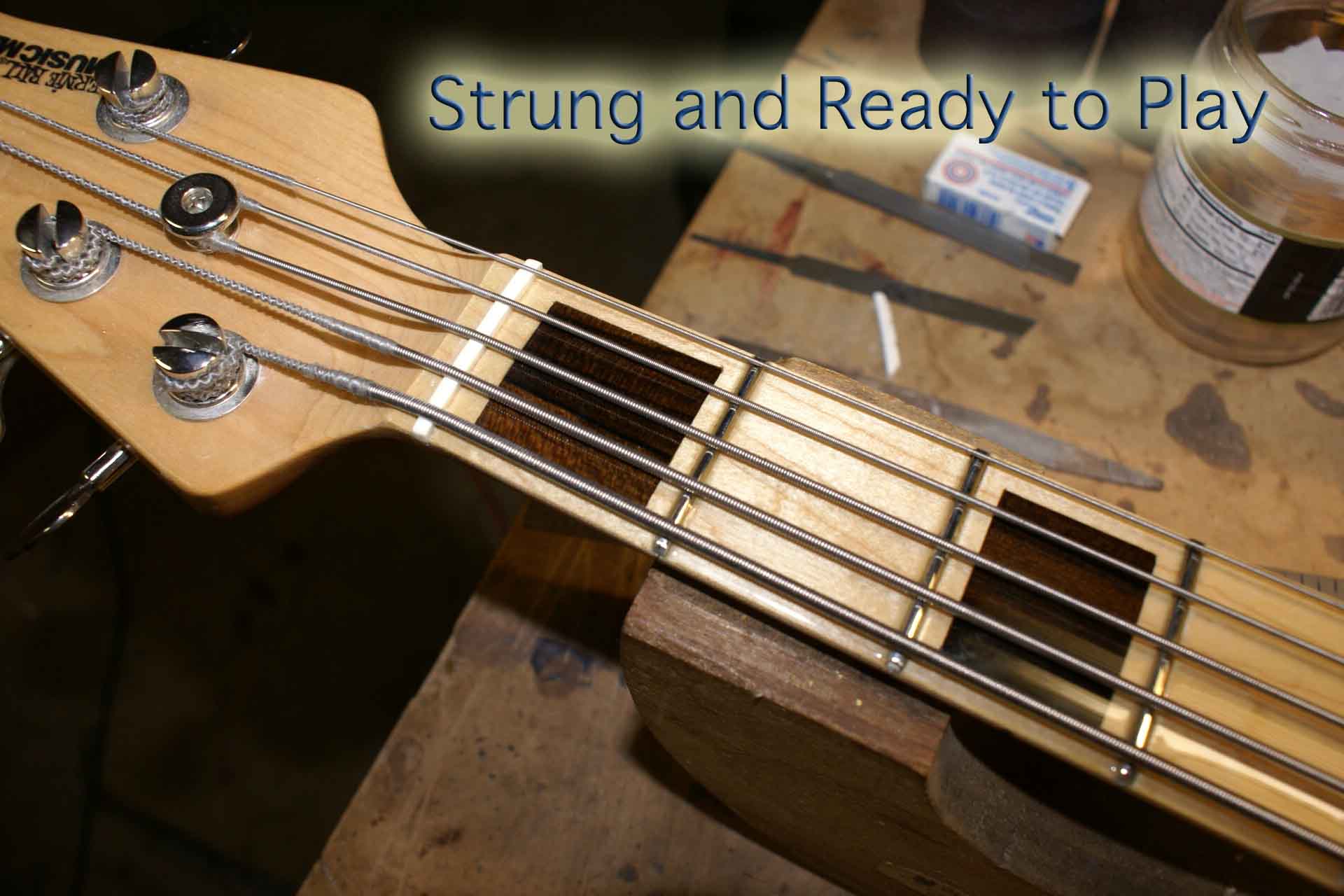

   If you want an absolute black, I'd recommend either phenolic or Gaboon Ebony, but if you're open to a dark block inlay with some color and character to contrast the Maple you can consider other woods.
   I recently converted a fingerboard on a Music Man 5 string used by my bass player in my church from dots to Zircote blocks and it looked great when it wa done.
   Very dark with a hard contrast to the Maple, but with great lines ad color to add interest.
   Here are a couple of photos of the inlays.
Regards,
Kevin Gallagher/Omega Guitars
PostPosted: Tue Dec 25, 2007 2:14 am
Posts: 1041
    Last week, I couldn't get images to post for me, but I'm obviously making up for that with these.
Sorry guys,
