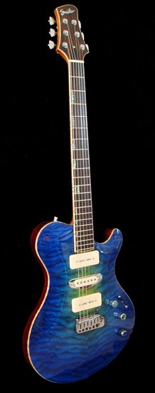

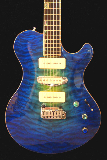

PostPosted: Wed Dec 26, 2007 7:21 am
Posts: 1018
Location: Denver, Colorado
Sorry, j, they're not closeups. One rectangles, one none. I like none
myself.

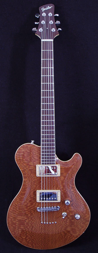

PostPosted: Wed Dec 26, 2007 7:29 am
Posts: 1018
More with none

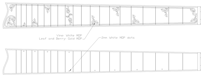

Well I have no pictures of anything other than the typical marker set up or vines you have already seen of mine, here at work, but here is two different projects I have coming up in a cad drawing.
The first is a Art Nouveau project inspired by a John Greven inlay. Just re-shaped a bit to git my fretboard shape. The vine will be White figured MOP and the leafs and berries will be Gold MOP
The second is a simple but stealthy set up 2mm MOP dots 1/8 off lower edge at 3-9 and upper edge 15-19. The 12 hyas the dots at both edges. This is so non-distracting from the wood on the board it is almost invisible.
