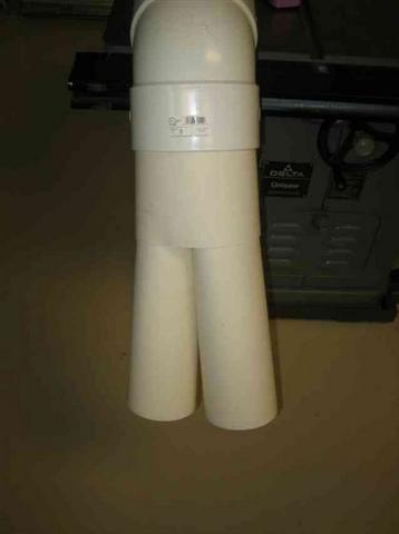

Danny, here is a picture from a user. I think we are forced to use 4 and 2 inch connectors at the machines, because that is what they are manufactured with.
The issue is entraining the most dangerous particles, it takes a lot of velocity. 6 inch pipe, 3 HP motor, few turns in the pipe, no restrictions.
One of the guys showing his shop devised a simple six by four four wye. Here is a pic:
He puts blast gates at all these six inch drops. I'm wondering where to get six inch blast gates? Also, I wonder how he sealed off the 4 inch pipes? I see an attaching screw to the 6 inch.

Bruce, that home built "y" looks like it could be made to work. Here in
Canada we're fortunate to to benefit from the wisdom of guys like Red
Green. The man has a way with duct tape.
Todd, What did you use for flanges on your machines?   A bit of caulking
and a few screws or pop rivets I guess?
