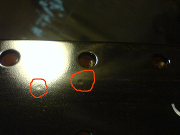

Thanks for your response. I went ahead and gap filled, levelled (somewhat), and applied the final five coats last Saturday. Since I had family coming in that day, I had to get the finish on, then get cleaned up in time for their arrival. Hours later, while showing off my handiwork to my sister and bro-in-law, I began to notice numerous small circular indentations on the granadillo sides and ebony head plates of both. This phenomenon was definitely not present after the first five coats, and I haven't noticed it on the mahogany back, sides, or necks at all. Here are a couple of examples shot in raking light:
Any idea what might have caused this? I'm hopeful that these will sand/buff out, but if they don't, do I have any recourse? It will be at least ten days before I can begin the final sanding/buffing process.

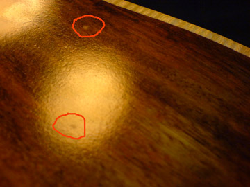

Also, in the second image you can see the texture on the surface that I have to work with. On my first build, I don't recall the surface being any worse than this, and I was able to get it fairly smooth.

The dents are likely cause by moisture in your air supply. wipe the area with DA allow to flash off and drop fill using a toothpick. allow to cure three days. Take a razor blade and grind the corners round. burnish a hook on the razor blade and use like a scraper and slowly and carfully scrape the drop fill to near level. Allow the finish to cure. The longer you can allow to cure the better.
Your not quite level yet on your film judging by the photos. There is still a good bit of orange peel but it is getting close. That's OK.

I have had the same thing happen with Target USL and I found that it was as Michael said, moisture in my air line.  Actually, it is moisture and oil from the compressor.  Make sure you drain your tank of moisture and use a water trap so the air is perfectly dry and clean before it hits your spray gun.  Also, as Michael said it looks like you still have some leveling to do as both photo's show quite a bit of orange peel. Typically, my guitars look like that before I start level sanding.  Don't give up, you finish looks good it just needs a bit more work.  On my first 4 guitars I used Micromesh all the way through the 12000 grit level, but on my last ones, I have stopped at 3600 and then used buffing compounds to get the final finish.  It saves a lot of sanding, and also lowers the possibility of rub-through dramatically.  Although Micromesh says you won't remove enough material to rub through after about 3200 grit, I have rubbed through several times after 6000 grit so it is very possible.

Ken, Those actually look like fisheyes. Fisheyes are caused by contaminants in the air, in the air line, on the surface before applying clear, and also from your own body. Did you use any type of surface prepping solvents prior to applying the clear? This would be a wax and grease remover and is wiped on with a clean towel or rag and wiped off with another that is dry to remove the residue. be careful with paper towels as some of the glues in the consumer paper towels will cause fisheyes.  Sometimes you can dab some clear into the (crater) fisheye and level it when you level sand later and get an acceptable result. Wax, grease, oil, some deodorants, and even your own body oils can cause fisheyes.
The craters could also be solvent pops which can be caused from applying too much material too quickly and trapping solvents that later make their way back through the layers of clear. Best way to avoid these is to allow good flash times between coats of clear.

Many thanks, Michael and David for your excellent advice. That makes sense that the indentations are from moisture, though I do have a trap on my compressor. Here's a dumb question: would water do that even though it's a waterborne finish? Or perhaps it is oil as David suggested?
I'll try the drop fill method on the deeper dents. Many of them are so shallow, I don't think they're any deeper than the texture I'll be smoothing anyway, so I'm hopeful they'll sand out.
Should I worry about adhesion of the dropped-in finish to the existing, five-day-cured finish? Or will the DA still cause them to fuse?

Thanks Joe. I was wondering if this was the fisheye effect I'd read about, and so hoped to avoid... I'm wondering if the DA itself could've caused this. I sprayed the surface after levelling the first five coats, and I thought I allowed sufficient time for it to flash off. Anyone ever experience this?

Yes It will. The moisture generated in the compressed air flow is not pure. it will contain oil and other residue. Joe is right it is fish eye i am not sure he caught on to the fact we were talking about a waterborne hers so the solvent is H2O. The most common introduction to your finish will be through the air supply. But he is right it could be the booth environment, anything suspended in the path of the spray or left on the surface of the wood can cause this. Nothing changes about what I said to remedy the issue.
I am assuming you are using a hp gun or a HVLP conversion gun. Water traps sold in most hardware stores will not eliminate 100% of the condensation in the line. If you are using a hp gun you really need a dryer as well and they are expensive.

Yes DA our any contaminate can cause this. Notice I said wipe not spray DA. I find wiping will remove most all contaminates that may have gotten on the finish and leaves behind a lighter loading and will flash quicker.
I personally still believe the issue was moisture in the line. It is the most common cause. Are you using a hose set dedicated solely to spraying. If mot you really should. An old hoses that have been previously use with out a scrubber, water trap and oil trap will have all sorts of gunk in the line that can get to your gun.

Oh I forgot! You should have no problems with adhesion on the drop fill after a DA wipe down and flash off. You must be sure the area is clean and dust free. I would fill the shallow ones as well. a small drop goes a long way. Avoid over filling. practise the technique first.
