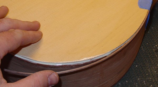

If you are thinking about making your own purf, check out this tool before spending the big bucks on the LN.
I used this wood strip cutter from MicroMark, on my current build. It took a little practice to get it right. As any slicer would, it really wanted to follow the grain. Many light cuts is the key to getting a nice slice. I didn't get any photos using the slicer, but here is the result.
I used to have an old Exacto one that I used when building model rockets. It disappeared twenty years ago and was probably produced in the 70's. It was a black body with an iron plate and fit (contoured) in the palm of your hand. I would love to have that one back.
