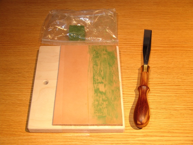

Lots of practice on scrap (and sharpening) will pay off- get in the habit of working 'bevel-down' when needed. You really don't need this:
if you know how to handle a regular chisel.
