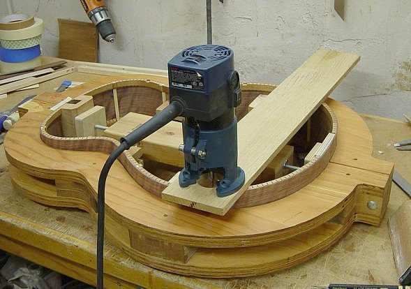

All this talk about making notches for braces... I had to do tonight, so I thought I'd post a few pics.
I followed the method Cumpiano describes on the very first guitar I ever made and I knew there had to be a better way--that was awful.
So here it is, pretty simple.

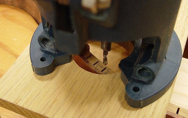

A laminate trimmer with 1/8" downshear bit stuck on a long board. The board is longish so I can lay it across the rims to follow the trajectory of the brace.

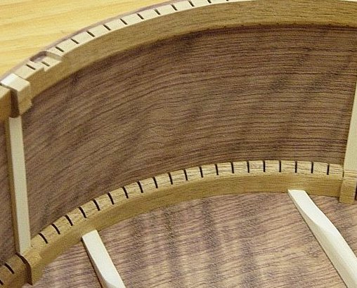

Last picture shows the finished back braces installed and a notch in the linigs up on top. I don't bust through the sides because I find it helps to locate the top a bit for more easily for gluing.

Jeff, my pleasure. Cutting notches now takes me about 15 minutes.
PostPosted: Thu Mar 31, 2005 6:47 am
Bob, please explain how you get the braces to the precise size to fit in there. TIA?
PostPosted: Thu Mar 31, 2005 7:25 am
Joined: Mon Jan 24, 2005 10:38 am
Posts: 133
I align the plates and tape them firmly in place. I then use an exacto knife to mark the rims by lightly pressing the blade against the brace and making a single cut onto the top of the rim.
Once the brace locations are all marked on the rims, I flip over the mold and mark the braces with a pencil line against the linings.
I then pull off the tape and make a new mark 3/16" beyond the pencil mark which is my cut line. I then pare the end of every brace to 0.100" which is the depth at which I set the router bit.
Back to the rims. I place a straight edge across the rims that follows the path of the brace to make my pencil marks. I then mark them in such a way that I always "take" the pencil line with the router.
You can either either always "leave" the line or "take" the line, but you gotta pick one!
Hope that's clear.

PostPosted: Fri Apr 01, 2005 3:44 am
Bob I do just about exact the same but I clear cut the though the sides and cut the braces flush with the router after gule-up and before routing for binding.
