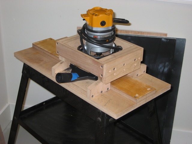

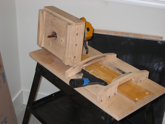

I built the router jig based on the Micheletti plans. Check here I have found the jig to be fast, accurate and simple to use.
On the slotting side I use the fine tablesaw blade provided by Shane and built a simple sled to cut the slots.

HERE is a supplementary to JJ thread on Rick Micheletti's jig. I have done a few boards with mine now and found it to be excellent for any number of various radii. It is fast, easy to use and simple set up. But like any jig, take your time when putting it together as it will only ever be as accurate as it's construction, build in an error and it will transfer to your workpiece, every time.

I have successfully produced a 12" to 20" radius on this jig for the electric I'm currently building...very simple.
Also...the original bit that was specified was done so in error. Rick has since specd a different one...flatter and it works much faster.

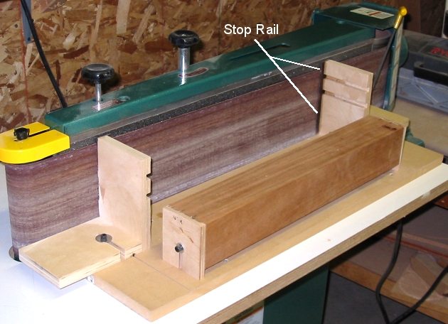

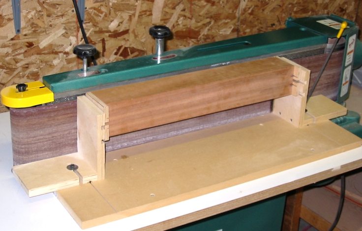

The fretboard mounts to the piece in the foreground with double stick tape (vacuum would work better). On each end is a pattern (same radius or different). The bolt that holds the pattern on rides in one of the slots on the jig. Having more than one slot allows you to use more of the sanding belt. The patterns then contact a stop rail that sits right next to the belt.
This is how it looks in use.
If you don't have an edge sander, this same concept can be made to work on a jointer.

It's been changed to a 3/4" Core Box Bit. I found one at Rockler... #90946. Check here
It works much better than the wrong bit and takes off more stock with fewer passes

Erik, to be honest, I'm not sure if this gives me a geometrically perfect compound or not.
For what it's worth, I'm not even shooting for a conical section. I started with the radius I wanted at the nut end and determined the radius that I thought would work best at the other end by working backwards from the curve of my saddles.
A conical section makes sense on paper but in reality, given relief and the fact that the strings tend to need progressively higher action from 1st to 6th, mathematically perfect geometry breaks down.
This jig does give me the radii I want at either end with a smooth transition between. And it gives me what I'm really after which is a linear surface under each string path, or at least something pretty darn close that has proven to be a better starting point than a cylindrical board.
And it was really easy to make, easy and quick to use, and easy to change if needed.

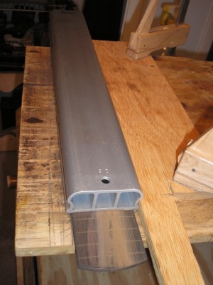

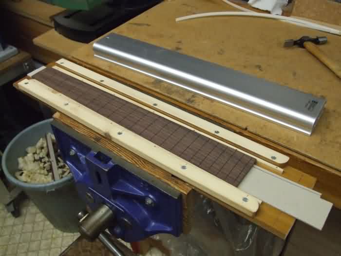

Elbow grease here! Love the Stew-Mac radius caul :

Same here Dave. The StewMac aluminium block really gives a perfectly flat end to end finger board. I have the 12 and 16" versions. If I built more instruments than one at a time, I would mechanise this process.

I made up some aluminum radius blocks, originally to sell, and though I don't use them to radius the boards they're really handy for levelling inlay. The benefit of any of the abrasive shaping setups is that you can shape the board with the inlay in it and save a lot of work (if you're the sort that does their own inlay).
