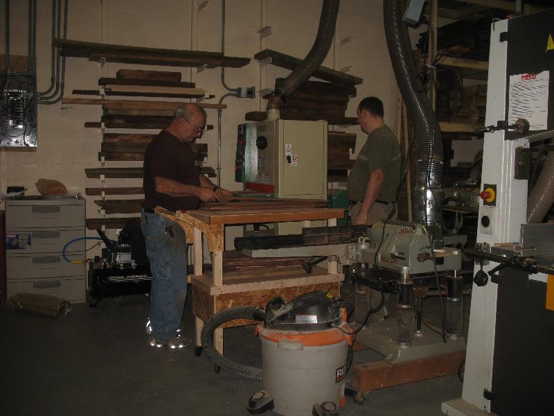

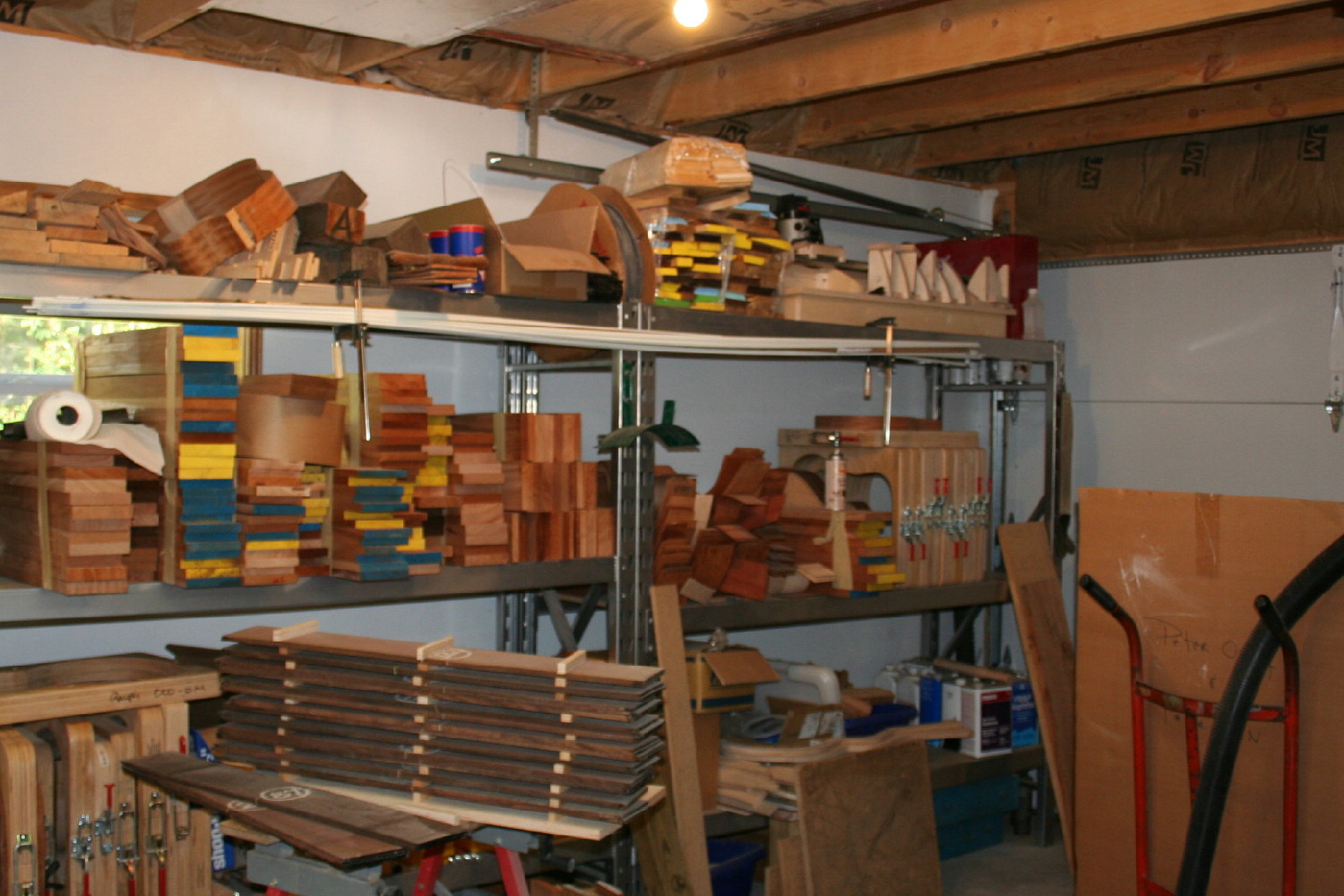

I finally got to try out my 18" Grizzly wide belt sander. Wow what an incredible machine. It's about 10 times faster than my Perfomax 22-44 sander. Well I don't know that for sure but it sure is a heck of lot faster. I sanded a some HRW sets yesterday and it sure works great. I need to do a bit of fine tuning plus the electric eye that keeps the belt alligned gets coated with sawdust and then won't work properly. I need to run a small air line and direct the flow on the sensor. So far I am really enjoying the new shop. New HVAC system keeps the shop warm and relative humidity at a pretty constant 45%

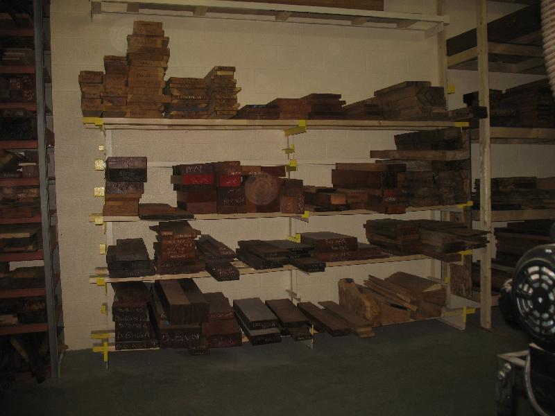

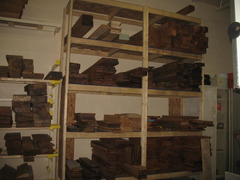

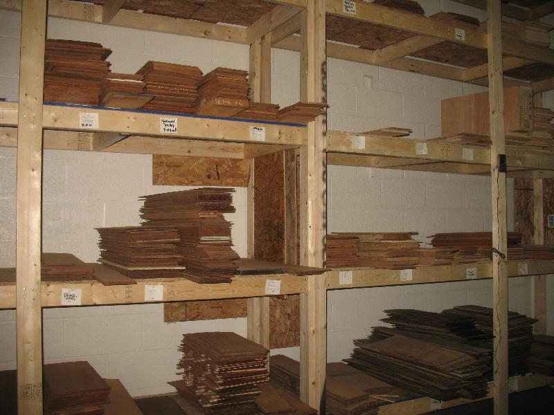

Here are a few pic's of the Grizzly and some of the billets waiting to be re-sawn.
Me and my son Pete
some sets waiting for pictures
Billets waiting for re-saw
Workbench in shipping station
fretboards, bridge blanks, head plates etc.

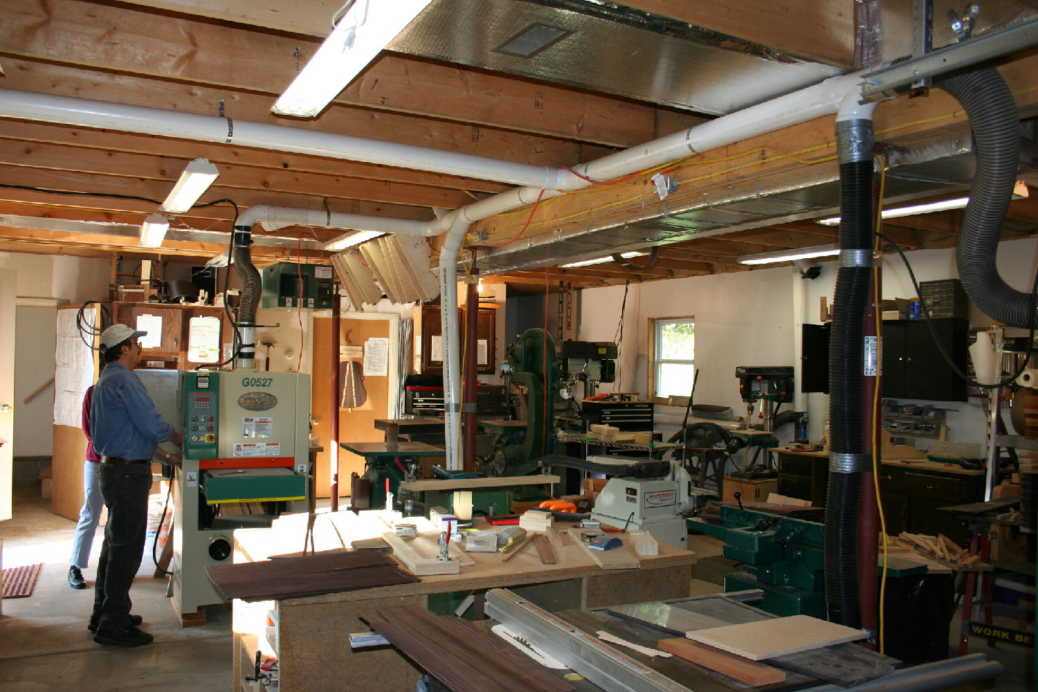

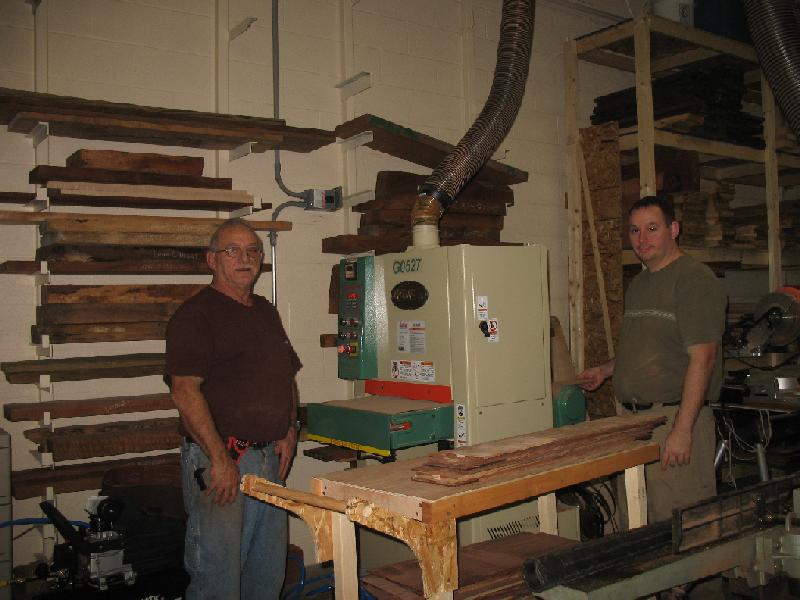

Here are a few pics of my shop and sander. I have found this to be one of the most used pieces in my shop.
