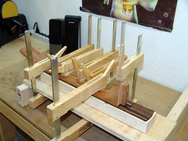

This is the first time that I have used West Systems epoxy to glue a fret board to a neck and I wanted to share my impressions with my OLF pals.
The move to epoxy from Titebond was to avoid the slight amount of warping that I seem to always get when using Titebond.  Although this warping was very slight it would require me to spend extra time leveling the fret board.
In addition, this was my first time using a product that John Watkins sells - a radiused, hard maple fret board caul.
West Systems epoxy is a real pleasure to use and I bought the stuff pre-packaged in single use packs.  It mixes very easily and completely and paints on thin enough that it tends to self level itself.  once clamped there was squeeze out all around but the squeeze out was not runny and very easy to clean up some what before it cured.
To my surprise, since I have sanded epoxy before in a prior life, this stuff sands like a dream and did not clog the paper at all.  I am very impressed with West Systems and will be using it again where ever it makes sense to do so.
John's fret board caul was also a pleasure to use.  Prior to applying the epoxy I did a dry run with my clamps and checked for gaps and there were none.  The caul also has dimples in if for registration pins and the area over the truss rod is routed out so as to not apply pressure there.
It all went very well, very fast, and I am very pleased with the results.  The fret board when checked with a straight edge is perfectly level which is better then any other time I have glued one on in the past with Titebond.
Here are some pics.

Yikes! Next time, use some waxed paper between that caul and the fretboard, because eventually, some epoxy will get in there, and you'll lose 'em both!
PostPosted: Sun Dec 30, 2007 11:13 am
Posts: 2711
Location: Victoria, BC
Last Name: Abercrombie
Hesh-
You should really use some thickener when gluing/laminating with epoxy, though this is such a low-stress application that you can get away with using straight epoxy, no doubt.
You can also use clear 'packing tape' over your caul to keep it from being glued- I'm kinda sloppy so I usually use wax paper and packing tape.

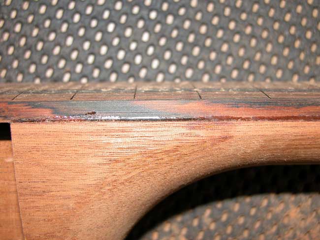

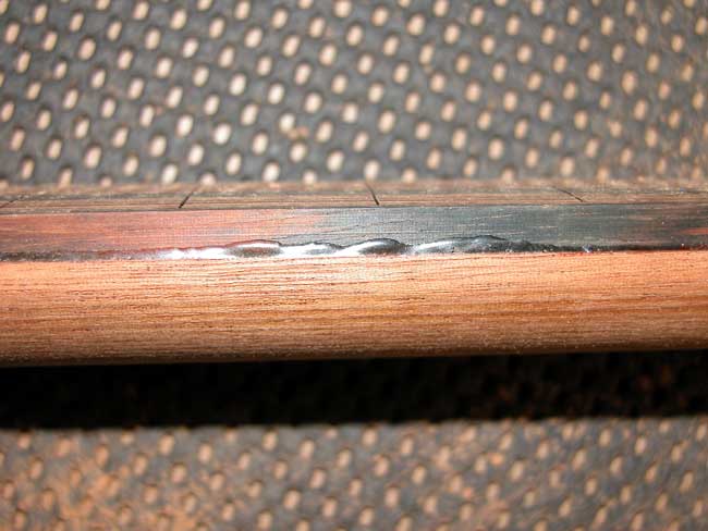

Good point guys but I was so impressed with the viscosity (pretty thin) of this West Systems that I decided that I did not need the waxed paper that I had already cut out.  The waxed paper also made the caul pretty slippery.
I am pretty neat with my gluing, an understatement, and I am looking for squeeze out all around but nothing more then a very small amount of squeeze out which is what I in fact received.  The other nice thing about this epoxy is that the squeeze out, though minimal, was not runny at all.  So I nixed the waxed paper.
Grump I am glad that you weighed in here because I wanted to ask you something else.  I have long been a fan of your method of pressing frets into the fret board prior to gluing the fret board to the neck.  But since I have never used this caul before I decided to fret the neck after gluing the fret board to the neck.  But my question for you is do you think that I could have fretted the fret board prior to gluing and then used the caul and clamps (waxed paper too) as in the pics above?  The caul would of course now be in contact with the frets and not the fret board.
Here are some pics of the squeeze out and you can see how it is minimal and stayed put and did not drip.

[QUOTE=fmorelli]Hesh,
   If you wish to fret first, you can slot the caul so it presses on the fretboard, not the frets.
Filippo[/QUOTE]
Now there is a good idea!!!!  But I would have to buy a stinkin table saw to do that.........

I used the same system for the first time today as well.  Had a fretted board so used clamping blocks radiused to match the board.  Very easy to use, I found the viscosity a little thin but nothing I could not deal with.  Used wax paper under the clamps but had a little extra seep out, tried to clean it up as best I could. This one is getting a shellac finish so hopefully it won't give the same results as the lacquer problem already noted.  Seems like a good system, tomorrow will clean up and see how it looks.

Yeah Hesh, fret first, and use the same system you did here.

I fret first, then use the radius caul as you did Hesh and clamp everything together using WEST Systems. Work's a treat.
You could always get some thin medium density foam/rubber to use as a gasket material between the caul and fret board.
