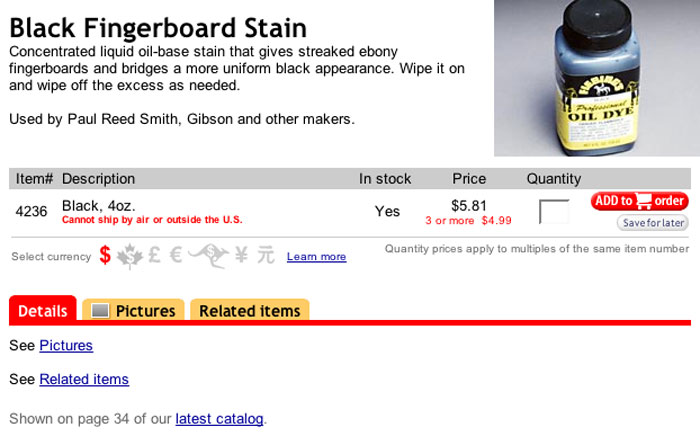

Andrew buddy Stew-Mac sells this stuff and it will make a fret board, head plate, etc. jet black.

You can often find Fiebings at leather and shoe repair shops. I get it from a shoe repair shop down the road from me. I have a friend who uses it on his harpsichord flats & sharps too, and it works quite well.
