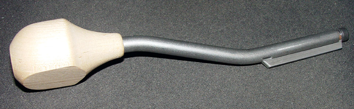

I like this diamond file from Stew-Mac.
PostPosted: Tue Jan 01, 2008 3:26 am
WE should start a thread of Tools I wish I hadn't bought. I have a small pile of those..... and one like yours in this picture...
