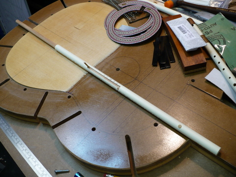

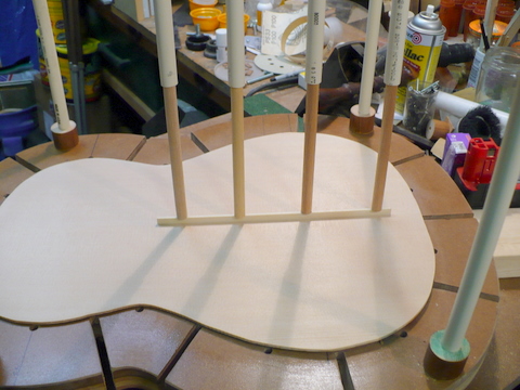

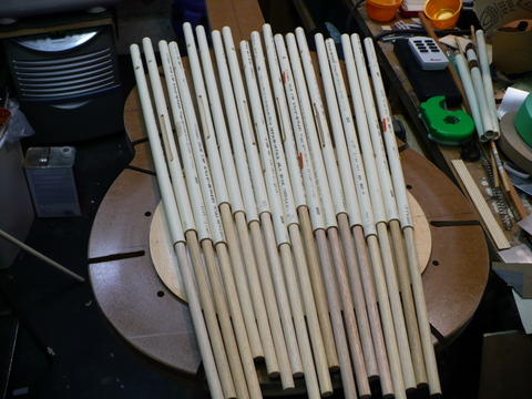

First things first though.  I had been working on a spring loaded go-bar, and posted a prototype before.  Here it is again.
Well, I finally got a bunch made, and still have to make some more, but ran out of dowels and CPVC.  Then I built a top for my solera that will break down very easily, since I don't really have room for a standard go-bar deck. I tried it out on a spare top and a 3.5x7mm fan brace to see if it would work.  No glue.  Seems to be OK.
Close  Up

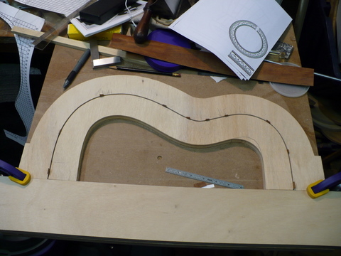

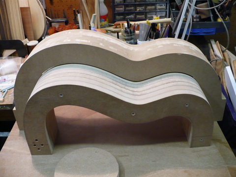

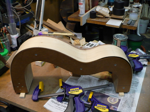

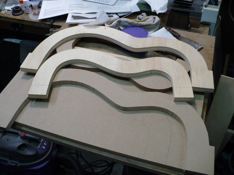

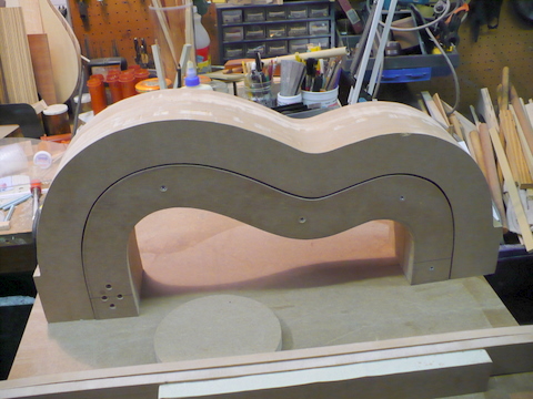

My next nit picky project was to make some molds.  I don't know why, but thought they might come in handy.  I made one inside mold and one outside mold.  Using the template method.
Now, some practice.  I resawed a piece of Poplar from some Home Depot stuff that was about 3 1/2" wide, and thinned to about 2mm.  Today I tried my hand at bending on the pipe.
It seems to fit the mold pretty closely, although it took some tweaking to get it there.  I really let it take a long time.  Just went slow, and kept trying it.

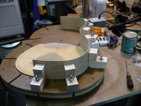

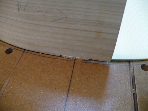

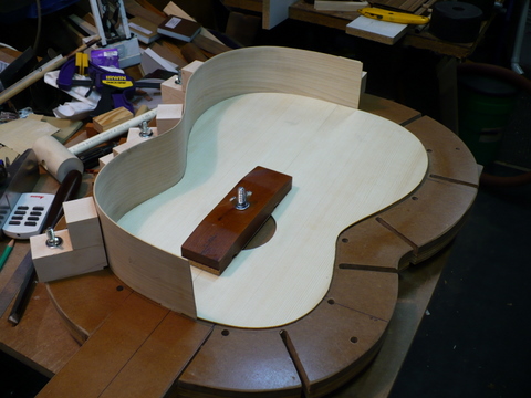

Alright, now to put the top in the Solera, and see if things fit.
That isn't too bad.  More tweaking to get things to fit right.  Had to do some spot sanding the edges of the top where it was a little bumpy, to smooth out the curves.  We're getting there.  Then I cut it to fit the little tongue that fits in the web between the neck slots.
Here is the lower bout.  You can see the raised portion of the Solera under the top.

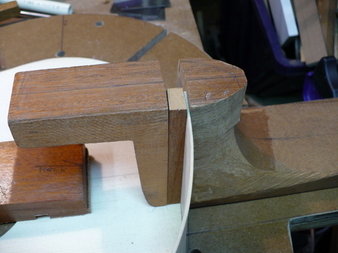

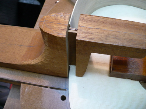

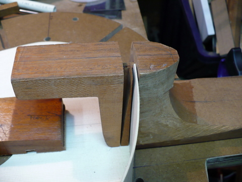

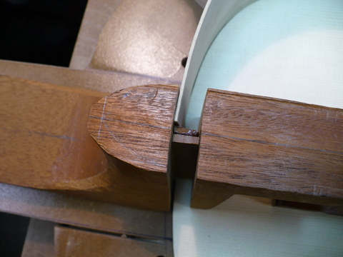

Now lets see if the neck will fit.  The neck is still very rough, and  will need to be worked some more before fitting to the real sides, but it will do for seeing how things might fit. I still have not cut the rebate where the top will glue to the neck, but it is close enough to see how things might fit up.
Seems like I'm getting close to a good fit.  I wonder how this Romanillos Wedge Neck Joint will work.  Let's try it out.  First wedge in place.
Next wedge locks rib against the neck heel.  Seems to work, at least for a first try without any glue.
This would seem to work.  I think I'll have a little more confidence now to actually bend my sides and start this whole assembly process.  Maybe I'll have a guitar closed up in a couple of weeks.  We'll see.  It is very interesting to try out these new things.

Your "hold down" bar should extend back to the vicinity of the bridge area on the top and should in turn hold a notched bar to jump crosswise over the fan braces (arched to match the curvature). You can then use the notched bar as a bridge caul when you get to that stage.
As we discussed in the other thread you should profile your heel  more closely to it's final form....looks like it's quite a bit more massive than it needs to be at this stage.
Also find a way to attach your hold down bar so that it can be removed once the body is together......you won't be able to undo that wing nut once the back is on!!

I realize that the hold down is not right for when I have the braces glued down.  I intend to make another bar.  This one was made for the Solera when it was based on the Courtnall plan.  The wing nut is on an threaded rod with double nuts locked on the other end.  It can be removed from either side of the Solera.  I know the neck is not even close to ready.  I was just seeing how stuff fits together.  It has been a curiosity since I started this process last Spring.  I wanted to test the wedge thing, to see if I was even close.  Looks like I'm not too far off.  I may need to adjust the wedges a little to fit the slots better, but that shouldn't be too hard.
Thanks for your tips, though.  Next step is to get some braces glued down, bend my real sides, and start assembly for real.  I may make some more go-bars though before gluing.  I only have about 19 of them.  Another 9 or 10 would be helpful.  I designed them so I can take the spacer out of the top of the tube, and use the deck at the same height to clamp on the back.  I think I am going to try installing the back braces in the guitar body before gluing the back.  I like the looks of that process.  I am, however, always open to suggestions or  reasons to change the way I should proceed.

Everything looks great and I really like the spring loaded go-bars.

It's ALL great, but I really like how you made the pipe. That's as nice as the store bought products.

I like those go-bars. Jeronimo Pena Fernandez used a very intricate jig that incorporated lots of minitures of this type for clamping his fan braces.
Where'd you get the info' on the Romanillos wedge neck joint? Also, did the idea for the raised portion of the solera in the lower bouts come from Romanillos too? I saw that in John Bogdanovich's book and plan to try it.

Great stuff! What was your main source of info on the Romanillos method with the sides outside the top? I've seen the method referred to in text in various threads. Did you work from that alone or are there pics somewhere?
The batch I'm working on now follow the Bream Romanillos plan, but my solera ramp is the entire width of the guitar. I was planning on using the method in Bogdanovich's book, but having to taper the sides to proper fit so they will sit down evenly on the ramped solera seems fiddly. Having a flat surface to sit the sides down on seems much more sensible. I may go trim a couple of mm off my solera ramp.
Ditto on the wedged joint. Yours looks different from what I imagined based on the sketch in Courtnall's book.
That may just be me, though.

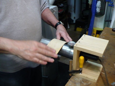

PostPosted: Mon Dec 31, 2007 1:50 am
Waddy...Great post. I'm not a classical builder but your methods are interesting.
One thing in particular I'd like more information...your homemade bender. Can you elaborate a bit on its construction...materials and heat source...TIA

Yes,Your bender does look very nice! I like the idea of a temp. gauge on it!

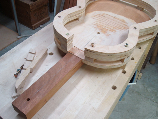

Waddy, installing the back braces into the body first is a time honored method and enables you to refine the back curvature using either a radius dish or curved sanding stick. Be sure to place props under the braces so that they won't deflect under the pressure of gluing the back. I'm assuming that you will use the go-bars to put the back on?? If you use the traditional cordage method, be sure to trim the back to the precise shape as any overhang will be leveraged up and ruin the joint.
The tricky part of this method is fitting the brace intersections with the center reinforcement strip as well as keeping the amount of squeeze out to a minimum. Once the back is on you won't be able to get back in to remove it. Fish glue is good for this operation as it gives you more open time than Titebond.
Stepping back to fitting the sides, be sure that the form/brackets allow the sides to rest well against the back of the heel, trimming the  profile is as much for this reason (so you can better see the "fit") as it is to lssen the amount of stock removal once the neck is inconveniently joined to the body.
I too am interested where you referenced the Romanillos technique........at the course in Siguenza last august he mentioned that his method book is soon to be published but I've never seen much if anything out there which explians it.

I have used the slotted heel method too, but i've made less deep cuts for a sturdier central shaft and used spruce wedges.

Hesh, the middle unit is a portable AC unit.  I vent it through a roof vent left over from an old gas hot water heater.  The only problem with it is that it uses inside air for the heat exchange, and that pulls in outside air which is, when you need the AC, usually very humid, so I have to run the AC and the dehumidifier at the same time.  Not very economical, but my wife said no window units.  Would have cost 1/3 as much and been 3 times more efficient.  Ah the price of a good hand built guitar!

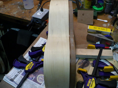

Bill and JJ, the pipe, is a truck tail pipe section which I got for about 7 or 8 bucks.  It was twice that long, so I cut it in half, then slit the other half and squeezed it inside the other section to give it a little more mass.  The heater is a 50 year old 5 watt soldering iron.  You know, one of those that has a heating unit about 1 1/2" in diameter.  It is very slow, but that is good for regulating the heat.  It takes 30 to 45 minutes to heat up, but it also takes a couple of hours to cool down.  I looked at it yesterday after it had been off for over an hour and it was still at over 200*.  I actually did a lot of my tweaking of the sides after it had been turned off for a good while.  Mostly I was too tight in the lower and upper bout curves, and had to stretch them a bit.  It was like helping springback.  I was wishing for some.
Max, I got most of my information from the Courtnall book and from Shawn here at OLF.  He was very generous with information he learned at the Romanillos class.  After reading about him and an article in one of the American Lutherie magazines, I was really taken with his attitude, and his way of thinking.  Then I read more about him in the Courtnall book and bought his book on Torres.  All very revealing about his and Torres' perceptions.  I also, somewhere, ran across This Link, which told me way more than I though I would have learned from about 7 pictures.  Very revealing.  Shawn had talked about the raised lower bout thing, but this made it clear.  It also gave me the idea about the spring loaded go-bars.

Dave A., the temp guage is just a BBQ grill one stuck in a hole that fits.

Alex, I actually ended up reinforcing the central shaft of my neck after following the directions I had from the Courtnall book.  In my opinion it was much too narrow, so I glued reinforcement strips in to thicken it up.

Waddy, that is a very impressive zero spring-back fit with the pipe bending, bare handed, no slat, how many attempts and how long did that take you? I don't see any scorched wood, it sits flat and no quilting/warping.
My first attempts on a pipe were not nearly so successful, especially at the waist. I ultimately built a fox style bender and use the pipe for touch-up. But if I would have had that result on a pipe I wouldn't have bothered.
The fox bender is great, but seeing your result I'm going to give the pipe another try.
PostPosted: Mon Dec 31, 2007 5:16 am
Marc, I really took my time, and went back and forth from the mold to the pipe checking the fit every time I made a little progress.  I was bending at between 325 and 350* mostly.  When the pipe would get to 350 I'd turn it off.  I did this bend by just spritzing the surface of the bend on the bend side and going straight to the pipe.  I did have a good bit of problem with the board wanting to cup where it was wet and not bent, and had to do some straightening.  I did that by keeping it on the pipe and putting pressure with another flat board as I slowly worked it across the surface.  It took care of most of it.  I can tell you though, it was not a fast bend, and I'm sure my next one won't be either.  I'm also not sure Poplar is a good bender.  It seems to be soft, mushy, sort of, and water soaks in rather than burning off.  I think that makes it warp more, though I stand to be corrected on that.  When I was fitting to the Solera, I had to do a bit of twisting to make it lie perfectly flat, and have vertical sides.

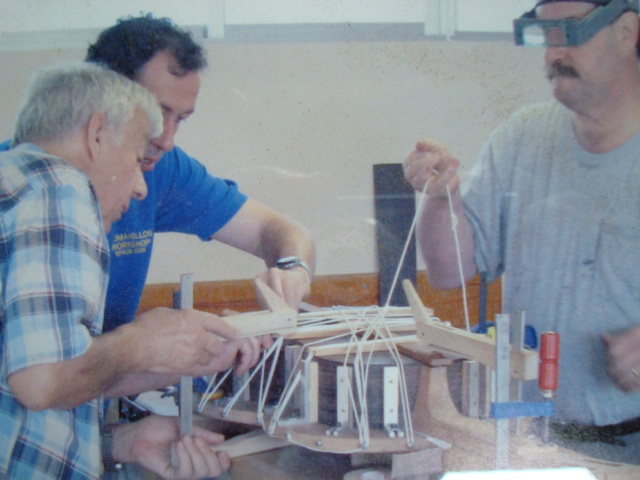

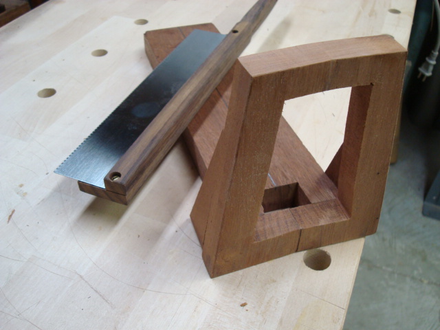

Thought these might be of interest. These are my fixtures which were derived from those used at the course in Siguenza. The solera is quite similar though I opted to make the solid side rails as opposed to the angle brackets. I may modify this by segmenting the rails and providing for a small amount of adjustability in and out to better snug the sides around the trimmed top....Note the hold down bar and bridge caul. Also note the contouring which has the high point at the bridge location and which extends right back through the sound hole area.
PostPosted: Mon Dec 31, 2007 9:40 am
Posts: 241

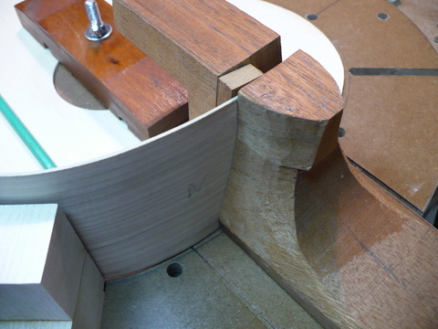

Here are some additional fixtures, this one is the holder for the neck to cut the solts for the sides and wedges. The saw is designed to cut fush to the back surface with a stop at the proper angle. Flipping the saw over automatically makes the 10 mm wide solt to receive the wedges.
PostPosted: Mon Dec 31, 2007 9:47 am
Posts: 241
Lastly, this is a shot of  Jose', Liam and myself gluing the back on my guitar in Siguenza.

What, you don't have one of Jose's double saws with spacer welded between them?
Thanks for posting the pictures.  The solid rib supports might be nice.  I like that you can slide them in and out.  Does the whole neck fit through your slot cutting jig? Do you cut it before shaping the foot side of the neck, while everything is still square? I cut mine by hand. Really hard to stay perfectly parallel, and I'm probably not, but I'm close.  I think adjusting the wedges a little will compensate. I asked before, but what surfaces do you glue on the wedges?  I know none on neck to sides - how about wedge to sides?  I assume you glue wedge to wedge, and wedge to neck, both at the foot and at the web between the slots.
You look like you're gonna snap Jose's hand with the rubber band.  Not Nice, Dave!

"Does the whole neck fit through your slot cutting jig? Do you cut it before shaping the foot side of the neck, while everything is still square?"-
I establish the basic taper of the neck block and shape the foot prior to cutting the slot. As shown the jig will only accept the blank through the opening with a taper. I suppose it could be made to accept the squared blank but one of the functions of the jig is to establish the wedge shaped center web between the heel and the neck block.The saw blade I used was limited in width and thus the angle. Once the slot is cut and cleared, I then can carve and establish the profile of the heel where it meets the sides.
" I asked before, but what surfaces do you glue on the wedges?  I know none on neck to sides - how about wedge to sides?  I assume you glue wedge to wedge, and wedge to neck, both at the foot and at the web between the slots."
Yes, wedge to wedge gets glue as well as wedge to side and wedge to neck block
Actually that cordage is 1/8" nylon with really no stretch......I was maintaining the tension while Jose' put a clamp on over a brace location. Note that the solera at the course had angled brackets and we used a triple cruciform "tree" which funneled the cord over the braces.
