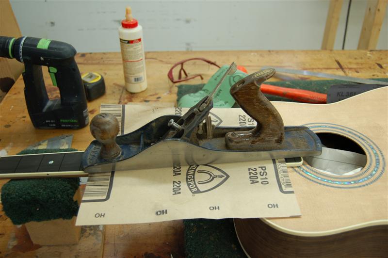

This is a very simple tutorial on fretting a bound fretboard.

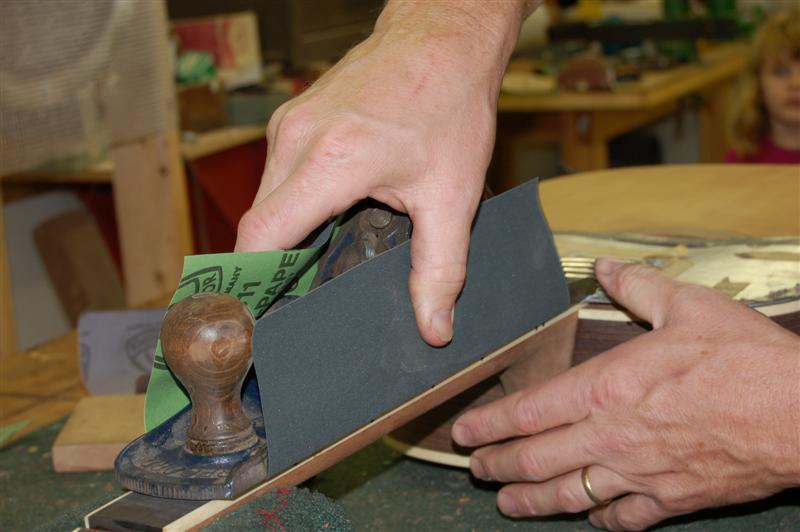

First, the board needs to be levelled-I use a jointer plane (blade removed!) with sandpaper wrwpped around it:

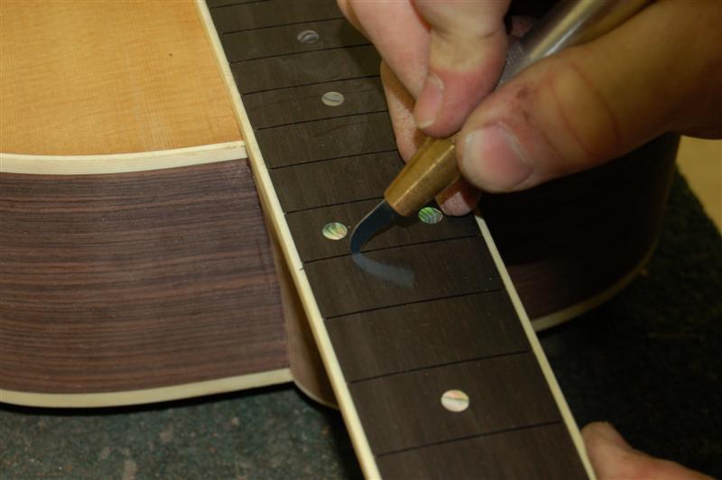

Once the board is levelled and brought out to 400 grit the slots need to be cleaned out-I use the Stew-Mac "fret cleaner outer tool thingee" (technical name)
for this:

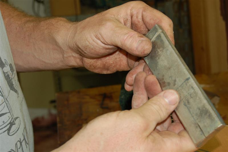

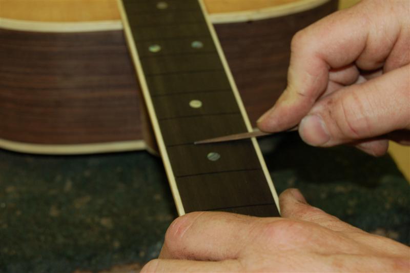

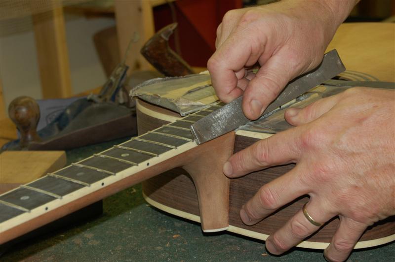

Then I use a triangular file to bevel the edge of all the slots-This is very important,it makes the frets go in(and come out)better:

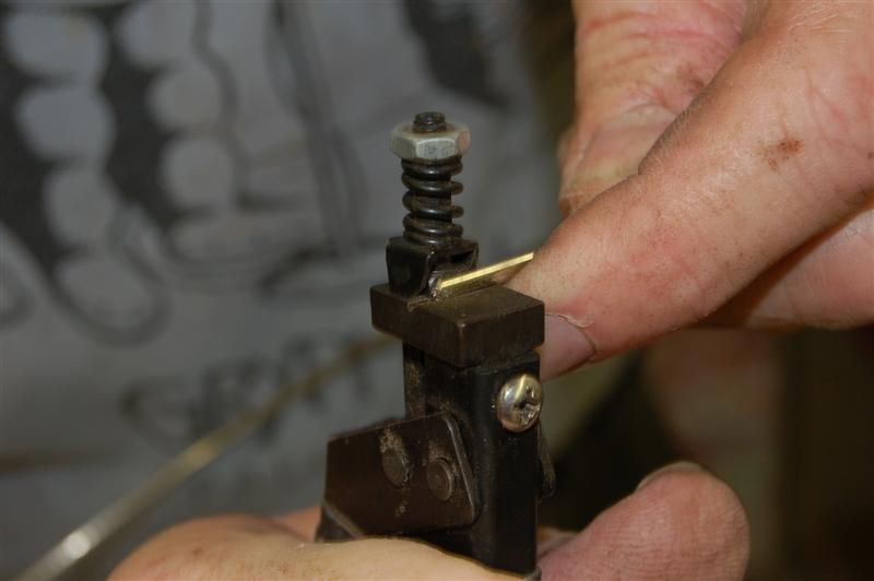

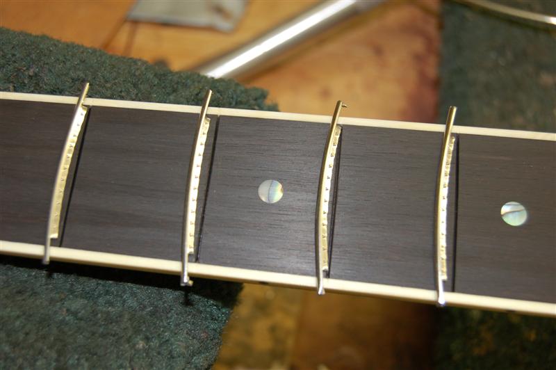

Now,I cut each fret with a nipper so it hangs over each side of the board by about 1/4":
Using the Stew-Mac fret tang nipper I nip the tangs so it is about 1/16" shorter than the binding on each side
I have to admit that I used to file the little piece of the tang ,but I guess I got lazy and haven't done it recently (I am now shamed into doing it next time-Thank you!!):

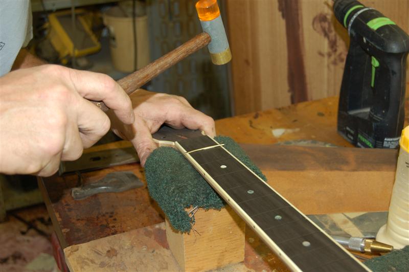

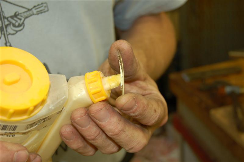

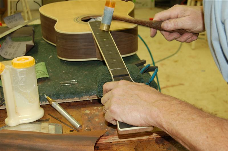

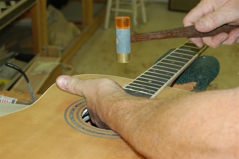

I cut about 4 frets at a time and apply a little yellow glue and hammer in the frets being carefull to keep them centerd so there is an equal gap at each side of the binding:
As I progress,I cut the ends off the the frets off flush with the binding-pushing down while cutting:

I tried doing the glue like that once and when I hammered in the fret glue went flying all over the place !!!
How do you control the glue ???
Mark

I enjoyed it as well. Nice photos and beveling the fret slot makes sense! Is that triangular file curved? I couldn't tell from the photo, just wondered how you keep it from coming in contact with the binding?

Mark,
I use just a little titebond-it does get on the fretboard,I wipe it up with a wet cloth as I go.
Joe,
The file is straight,but the fretboard is curved so it doesn't really come in contact with the binding.

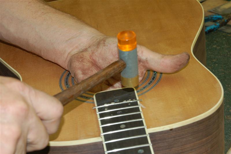

Once I get past the headblock I stick a heavy piece of metal under the the face inside the box to take the shock of hammering over the face:

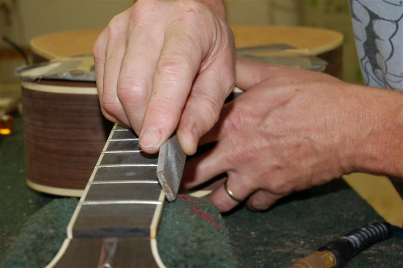

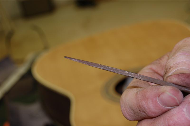

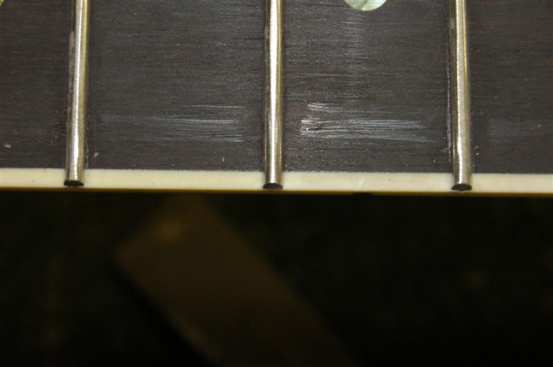

Now that all the frets are in,I use a fine file to bevel the edges of the frets to aprox. 35 degrees:
NOTICE the sheet metal protector on the face of the guitar-This is critical-don't ask me how I know!

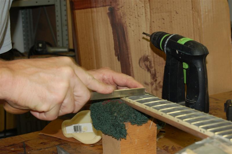

Finally I level the tops of the frets with sandpaper wrapped around the plane-then I reround them with a fret file and sand them usind protecters so I don't touch the board. later I will break the corners of the frets with a very fine needle file and buff them by machine:

Mark,
I use a pipette and put the glue directly into the slots - as long as you don't
overdue it you will have no cleanup. I might also mention that I try and
make sure the tang extends as close to the binding as possible - that might
not be necessary with normal fretwire but it is with stainless steel.
