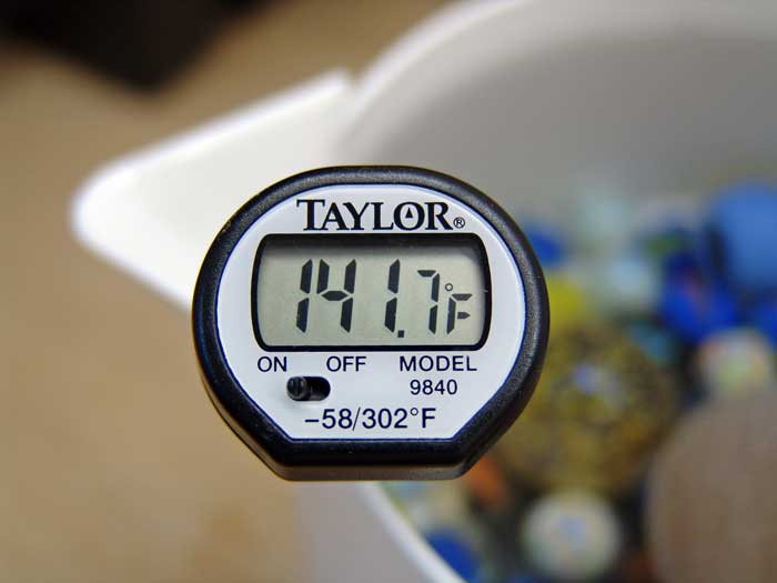

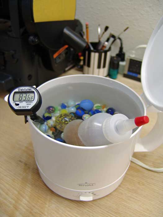

Kurt the Rival "Hot Pot" comes in two sizes and probably multiple colors too.  It works great.  Use marbles in the bottom so that your HHG bottle does not sit directly on the heating element.
In the tutorials section there is a tutorial on how to mix it, use it, tips, etc.
The rival Hot Pot can be converted to add a suspended jar for brushing.  So far I just use these little 4,2, and 1 ounce squeeze bottles.
You do not want to heat it above 145F.

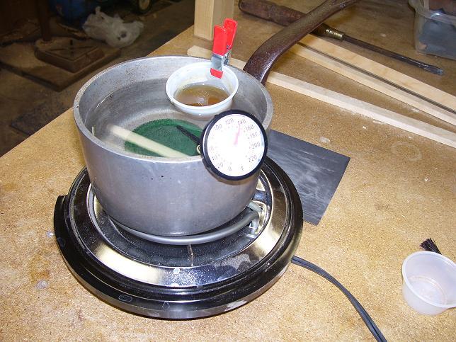

Kurt I use a small iron pot on a hot plate. I copied Hesh's idea with the marbles but i used these marble like rocks i found at a dollar store. They where for arts an crafts or something like that. I also use the small bottles. And i have the dial type kitchen thermometer. I'm still experimenting with it. You need to work fast with it compared to yellow glue. But if you do mess something up its not to hard to get apart like yellow glue. I got my glue at LMI so you know it will probably be fresh. I'd be weary about getting it on ebay or somewhere that does not deal with luthiers or antique repairers.

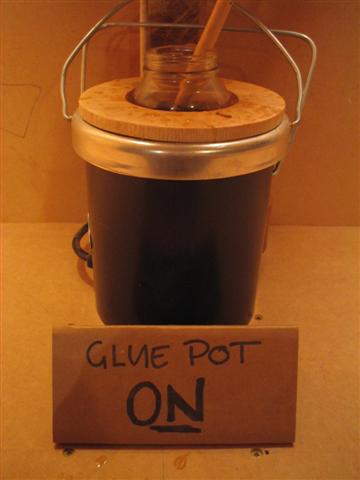

A $12 "Little Dipper" croc pot will hold 140 day in and day out. No adjustments, so there's nothing to g out of calibration.
the holdheet pot is nice, and it is perfect, but really, if it holds the temperature correctly, any device will do. A hundred bucks in difference buys a lot of other goodies <bg>
I notice your sign; is that a reminder to shut it off at day's end? If so, I understand completely(having left mine on for two days while I was sick and didn't go back to the shop!), and I will suggest buying a 4 hour timer. I bought one, wired it up with a short cable and an outlet9basically, cut a short extension cord in half, and wire the timer into a box with the cord). I use this timer for not only the pot, but for anything that heats up(irons, etc...). But 99% of the time, it's duty is wit the glue pot.

Rick HHG at 140ishF is runny and will puddle at that temp and then start to become more like jello in short order.  It takes a little practice if using a bottle to not squeeze it out to fast.  I think that I just invert the bottle, don't squeeze, and quickly run a glue line, position the part, and clamp all in 15 seconds or so.  Part of the beauty of HHG is that the cured glue joint is very, very thin on an molecular level.
I like the 1 ounce bottles for applying it and I am sure to make a very fine hole in the tip of the bottle so that it does not come out to fast.  I mix mine in a 4 ounce bottle only filling the bottle half way making about 2 ounces.  I transfer half of this to the 1 ounce bottle that I work with and keep the rest in the fridge until my one ounce bottle needs a refill.
10 ounces is a LOT of HHG.  I typically mix up about 2 ounces, use it for all braces, bridge plates, and the bridge and end up pitching more then half of it when I am done with the guitar.  It seems to keep for me in the fridge for at least 5 weeks and you can reheat the bottle many times.
Colin freezes HHG in small cubes that are ideal for single use times.  He also, if I remember this correctly uses a baby bottle warmer and I think that Dave White does too.
I bought a Little Dipper originally but must have got a bad one.  Mine fluctuates all over the place peaking at near 160F and cooling off below 130F so I don't use it.
