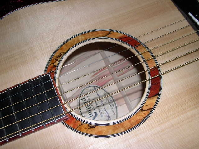

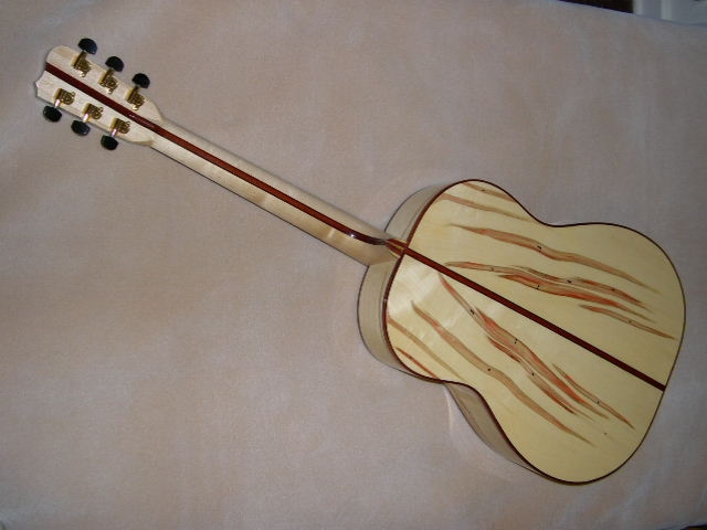

Jon, I have built the grand total of *one* Boxelder guitar. That's not a huge pool of experience to draw from, but at least I can speak to my experience with the wood. Of course, I'm speaking of the Ambrosia Maple set that Uncle Bob sold a couple of years ago. That batch was Boxelder. It is the softest maple I've ever seen, and was not unlike poplar. It didn't give the rosewood zingle, but nonetheless the guitar turned out nicely and a couple of people even liked the way it sounded. My set had that beautiful red streaking, so it was a treat for the eyes. It bent somewhat like cardboard, and was a dream to finish.
I've got pix somewhere...if I find them I'll post a shot.

PostPosted: Sat Jan 05, 2008 10:39 am
[QUOTE=jsimpson]
[QUOTE=Steve Kinnaird]My set had that beautiful red streaking, so it was a treat for the eyes. It bent somewhat like cardboard, and was a dream to finish. I've got pix somewhere...if I find them I'll post a shot. Steve[/QUOTE]
Excellent, Steve!  I'd love to see it!
Ok, Jon, I DID have some shots.
Here's the back, which as you see has bloodwood as a center inlay and binding. The blk/bloodwood/blk purfling also came from Uncle Bob:
Here's a good use for some spalted Amrosia:
Finally, my favorite shot of this guitar:
Thanks for looking, and appologies to those who've already seen this instrument.
