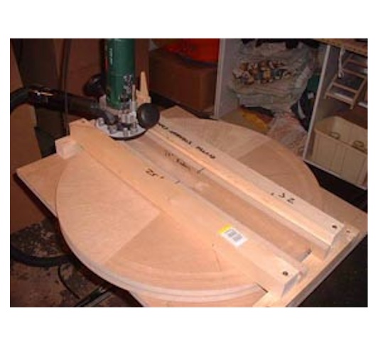

Hey Chris! Welcome to the OLF.  First of all, be forewarned that what you are proposing will create an unholy amount of fine dust!  That being said, here is a picture by Stuart Ketchin (from MIMF) that I based my dish making jig on.  Basically, make a bridge that has rails with the corresponding radius you are trying to achieve on which your router rides on ( 15', 25' etc).  Make a pass, rotate a little, make a pass, rotate a little, choke on dust, make a pass, .... you get the pic.  I used plexiglass templates (from LMI) and a pattern bit to make the rails.  Attach walls adjacent to your rails and set the width to match your router base.  Hope you can understand my explanation.  Anyway here is the pic and I am sure others will chime in.
PostPosted: Thu Jan 03, 2008 3:43 pm
Posts: 156
I guess I should've added that I made mine out of two pieces (laminated) of  3/4" particleboard but wish I had used MDF ( although that would make even more fine dust). I used a straight router bit.

I think Tommy is giving you good advice. That is probably the simplest way to
make dishes. You will need a jigsaw or bandsaw to cut the circle, or I think you
can buy 24" diameter mdf circles. Don't know if you know that I sell the radius
gauges that are used to draw your rails. I'm about $5 cheaper than LMI, and my
gauges are also convex and concave on each side. Good luck, and if you get
tired of making the dish, you can always purchase from me(ours are made on a
CNC machine). Best of luck!

I do it in a similar way to Tommy, except that I drill a hole in the
center for a dowel, and spin the dish with one hand while holding down
the router and moving it slowly down the track with the other.

I'm in process of making the jig that TommyC showed. I hear you on the tight budget issue.
The biggest concern is getting the correct radius. To do that I took some 1/4" hardboard, drew a straight line about 30" long to give breathing room. At the center I drove a small finish nail then two more an equal distance apart from the first one on that straight line.I then took a 30" steel rule and flexed it slightly so that it was in front of the midddle nail and behind the others. I then traced it and compared the curve to that of my plans(carefullly trace the top and back radius onto tracing paper). It wasn't right the first few times but after pulling out and re-nailing the outside nails closer or farther from the middle nail I finally got the curve to match perfectly. I did this for the top and back radii. I then cut them to within 1/16" lf the line and then hand sanded it the rest of the way careful not to obliterate the line. These will be my templates to make the "rails" for my router to ride on.
I'll trace the template onto 3/4" plywood and cut to 1/16" of the line with a jigsaw. Next,I'll tape the template to the plywood with double sided carpet tape and and run it through my homemade overhead pin router on my router table. You could do the same thing with a ball bearing pilot bit.

Just remember that if you are using a router to make your dishes that you figure out the distance from the router base to the end of the router bit. This distance (probably and inch or two) must be added to the router jig radius to get the dish to come out perfect. Yes...this is probably only a very small amount but it is worth getting it correct if you are going to take the trouble to lay things out.
Of course I didn't figure this out until after I finished my first set of dishes.
