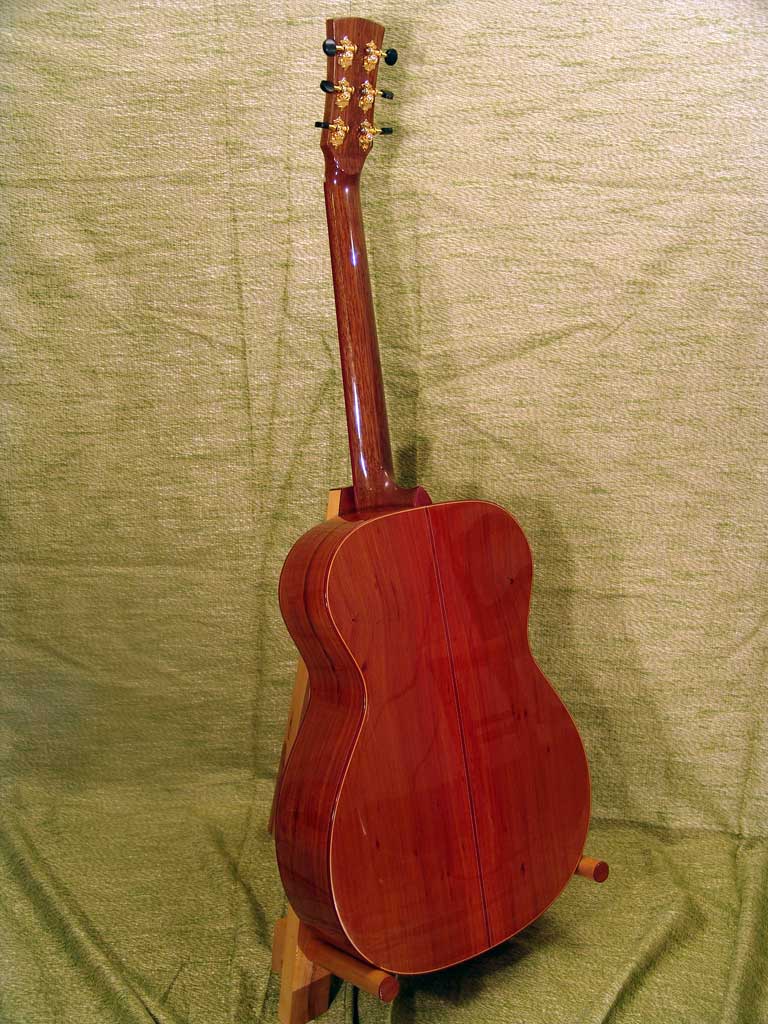

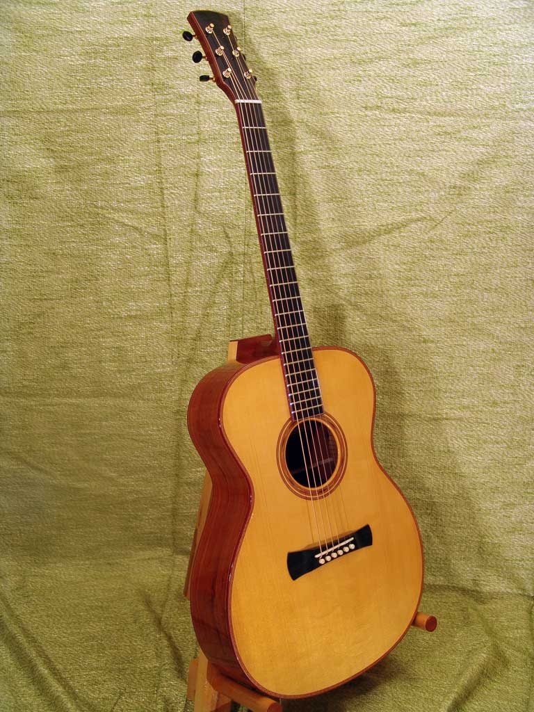

It's one of the guitars I completed at the end of last year. Happy new year 2008 by the way!
It's my take on the OM thing, perhaps a little rounder in the curves and with a deeper body. The Pau rosa set came from Bob and I have to say I really like this tonewood in spite of its (heavy) weight. The neck is made with Angelique, a mahogany substitute widely used in boat-building. It's heavier than the average Honduran mahogany, but lighter than any rosewood. I really like it and will use it again. Thanks for looking!

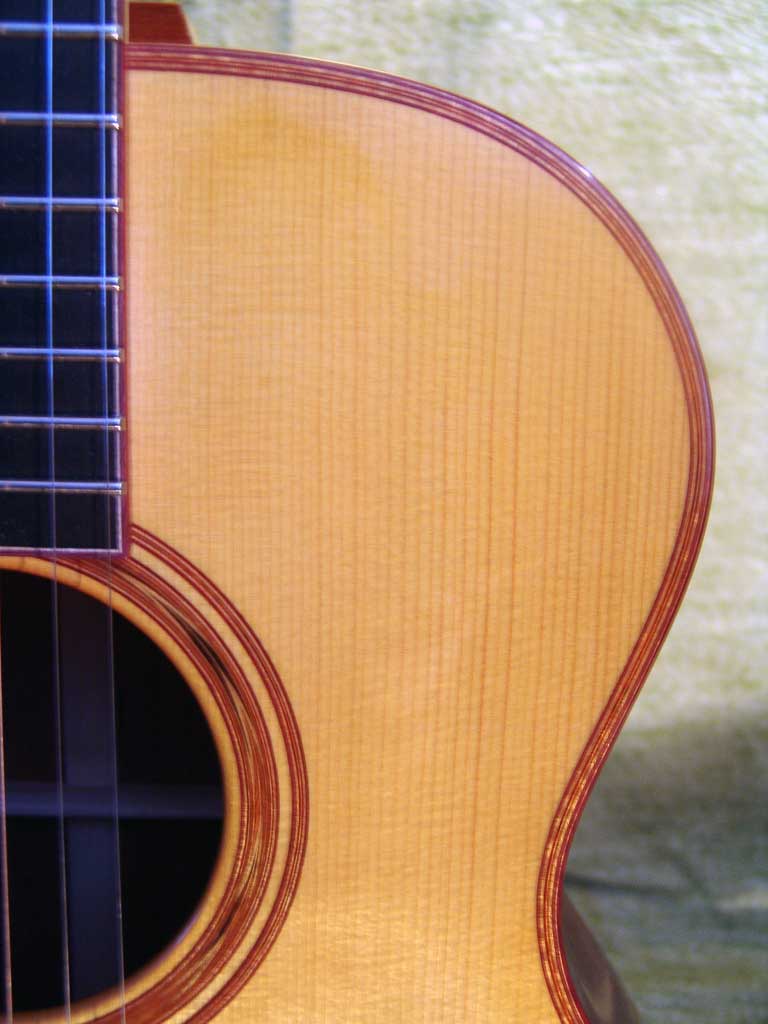

Very nice. I really like that rosette.

That is KILLER!  I, too, like the rosette, a lot.  Great aesthetics built into that guitar, all the way around.  Nice!

Nice guitar Laurent. I'm particularly interested in any more feedback you have on the Pau Rosa. I am just starting my first Pau Rosa build, an OM as well. My Pau Rosa is also a little heavy. Any more comments on the Pau Rosa - tone, thickness, bending?
David White, Toronto
PostPosted: Fri Jan 04, 2008 4:42 am
Posts: 1792
[QUOTE=drwhite] Nice guitar Laurent. I'm particularly interested in any more feedback you have on the Pau Rosa. I am just starting my first Pau Rosa build, an OM as well. My Pau Rosa is also a little heavy. Any more comments on the Pau Rosa - tone, thickness, bending?[/QUOTE]
It bends easily, no particular extra moisture or heat is required compared to, say, Honduran rosewood, although the wood is stiff, closed pores, but oily. It can be thinned quite a bit, I think the back is around .070" on this guitar. Tone is always tricky, it's a German top so… Anyway it compares to the harder RWs like cocobolo or Honduran, a lot of bass and clear attack with present overtones. It is also powerful, but again it could be more a function of the top. I'd have to build other Pau rosa guitars with different tops to judge. But I like it a lot.
