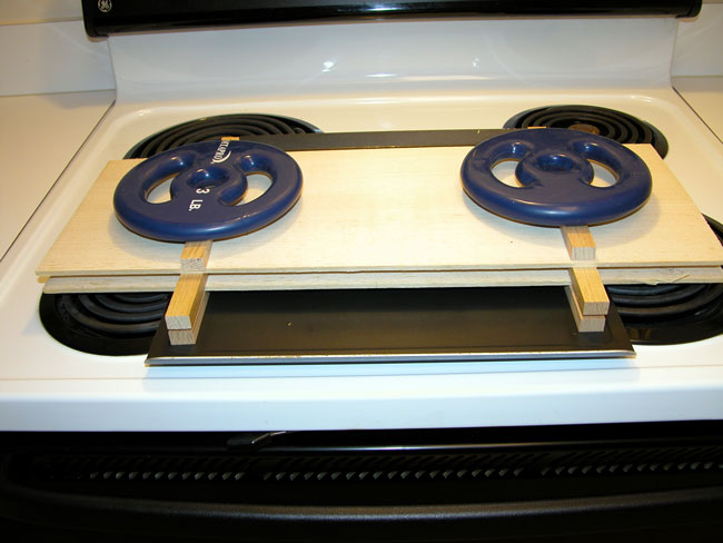

I just baked a top for my next guitar and thought that I would share what I do.
It's very simple:
1)  Adjust the oven racks so you are using one near the top of the oven - as far away from the heating element as possible.  Cleaning your oven prior is a good idea too if need be.
2)  Preheat the oven to 200F.
3)  Be sure that your top will fit in the over prior to step #2......
4)  I use a cookie sheet, stickers, and a couple of 3 pound weights that I cycled prior in the oven to make sure that the plastic won't melt.
5)  Stack as indicated in the pictures and place in the oven.  Set the timer for 1 hour.
6)  Order a pizza........ (optional)
7)  When the timer goes off turn the oven off.  I open the door slightly into the broil position and leave the stack in there for about another hour until it all cools down.
8)  Place the stack, still stickered, in your climate controlled shop.
9)  Wait two weeks or more before joining, thicknessing, installing the rosette, etc.
BTW this is some beautiful German spruce from Uncle Bob and it will be mated with some beautiful Cuban Mahogany, also from Uncle Bob, for an OM.
Thanks for looking!

       Now! Is the weight and stickering necessary or are you just taking extra steps just in case?
       The reason I'm asking is, I heard when you go to sleep at night you weight and sticker yourself to keep from getting more twisted! At least, that's what JJ said!
    Seriously, I was just curious!
PostPosted: Mon Jan 07, 2008 1:03 am
Posts: 13707
If your oven is not large enough just be sure to check and see if the guitar size that you wish to build is small enough to fit.  I can put a dread sized top in my oven but I often have to trim the plates first.
Paul buddy I preheat simply because the heating element, once the oven is preheated, does not stay on long at all to maintain 200F.  I was always fearful that if I put the zoot in there and then preheat the heating elements will be on longer and increase the risk of a fire.  But I don't know this to be true, it just seems like an easy precaution to take to me.
Alex my friend I think that the fire that we read about happened because of preheating with the wood in the oven.
Pat yep my oven is dirty..........  It just seems like a lot of work to me to press that button and flip that door latch.....
Skin buddy and Billy my friend I am planning on trying that:
