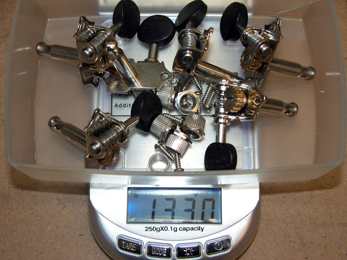

The lightest tuners that I have found, and I have been weighing them, were all open backs and open backs are FAR lighter then closed back tuners - often 100 grams lighter.
So far the lightest that I have found are Waverlys with wood buttons - in the 130 gram range (this includes all bushings and screws).

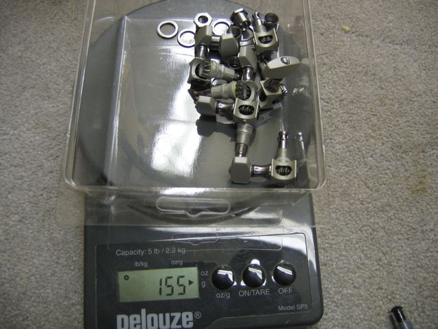

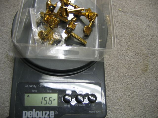

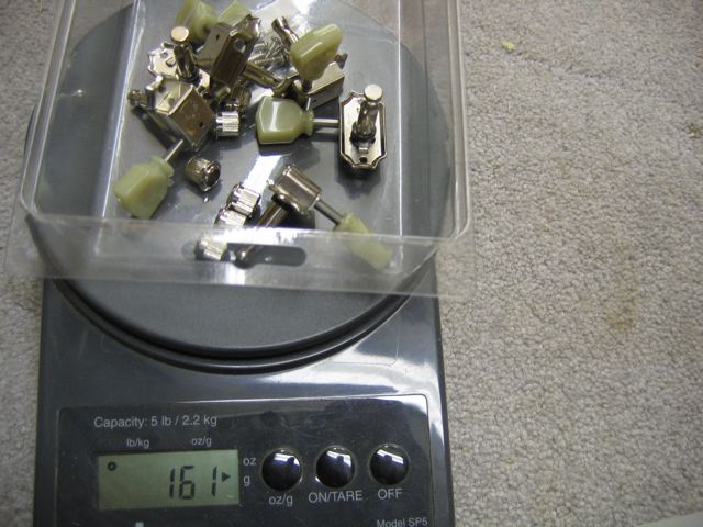

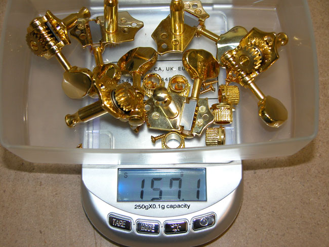

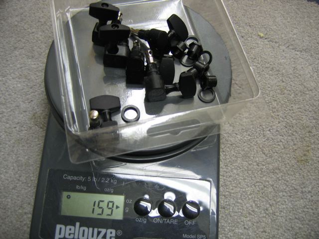

I just took some tuners and weighed them for you all. Sperzels and Gotohs.
First are Sperzel closed back with small button. They are 159g, 5.6 oz
Next, Sperzel open back tuners with small button. They are 155g, 5.4 oz

Next, Gotoh open back with steel buttons and slothead posts. 156g, 5.5 oz
Next, the set I am putting on my ES335, Gotoh Kluson style. 161g, 5.6 oz
