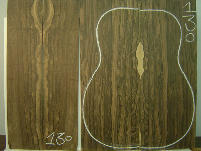

At the moment, I'm guessing #4 wouldn’t be too early to start itching to use the stash (Which is only 1 top and 1 backside set), but I can be patient. Being tonedeaf, I'm not sure how much it'll matter anyway.
By the way, here's the twinkle in my eye.

Gorgeous Ziricote
Ok I must be honest with you here That wood is probably one of the hardest wood to try to work with for a first timer. It will split along the figure lines with little or no persuasion.
I am not going to try to talk you out of using it. if your mind is made up to charge a head and this will be a one time build your going to do it.
I would try to seek out a luthier in your area to ask for help form till you have the box closed. Most of us would be glad to help you get through the difficult parts if asked.
Also if you do have a with the grain split happen, don't panic there are ways to deal with it that will never show.
I am guessing you gave in the $250-$300 range for that set. to me it would be worth building at least one simple Mahogany/Spruce guitar first. that way you would at least have an idea of where handling issues will arise.
Do you have a bender set up or plan to use a pipe or bending iron? If you have set-up a bender you might consider saturating the sides with thin CA and allowing to cure then sand the sides back to wood prior to bending. The CA will help to prevent splitting along the figure lines with the grain, the most problematic issue with Ziricote.
Really Try to find an experienced luthier in your area and take advantage of his help. This really is not a forgiving wood to work with at all.

"Gorgeous Ziricote" & "That wood is probably one of the hardest wood to try to work with for a first timer."
Thanks for the warning and i am well aware of that. i do want to say that i have been picking all of your brains silently here for a couple of years and if you can no longer remember where you left your carkeys well, perhaps i took a little too much. To be honest, i really wanted something of a challenge and i admit that this piece scares the heck out of me! I watched the various sites for quite a while and finally got this from on ebay for $33.95 (no reserve!) - Kidding! I think it ran me about 250, you're spot on.

Michael - sorry but you misread... i only WORK with someone who took the course, and that's just one step above having an ex-girlfriend who had a sister that knew somebody who heard of someone that took the course...

Now that is a set of Ziricote!  Where in the world did you pick up a set like that?

Funny to see that ziricote pop up now. I talked myself out of this set yesterday as I thought my first attempt at bending sides might not end well with it. I love myrtle and was glad to hear it bends nicely.

Hmm, the pic of 274 on hibdonhardwood.com is way worse than this

I believe that is from the same board as the Zircote that was in the OLF
woodshed. OLF23 I believe from Hibdon. I always wanted to get it, but
kept putting it off. Then it was gone.
