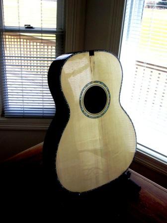

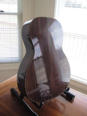

I wet-sanded to 12,000 Micromesh then buffed with Menzerna Fine & Extra Fine. Feel free to comment.

Very well done JJ. Nice high gloss and classy box

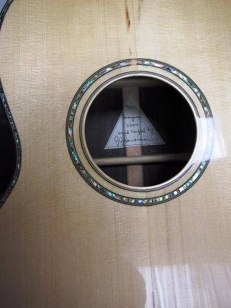

Id like to see some close ups --
The Rosette, bindings etc --

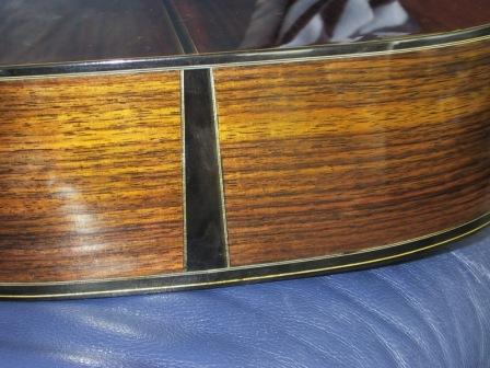

PostPosted: Tue Apr 05, 2005 7:57 am
Butt Wedge
Rosette

Don...While the finish is shiny and clear it's not possible to see the flaws that I can't seem to buff out.
It doesn't quite make it as a true mirror finish. I'm not sure how to describe it, but there are randomly scattered sections where it appears to be slightly diffractive as opposed to being totally reflective. I actually noticed this as I was wet sanding. It almost looked like water was trapped deep in the finish. After allowing it to hang for 10 days while I was traveling I was hoping that if it was water, that it would dissipate by the time I returned. Well, it didn't, and as buffing out did somewhat improve the look, it's still there to some extent.
On the other hand, the neck was wet-sanded last night after the finish was sprayed on 3 weeks ago. After finishing the wet sanding, I immediately started to buff and it has a more homogeneous-looking finish. However, it's not as shiny! Assuming that the surface may be too soft, I plan to re-buff the neck in a week or two.
I'm totally working by the seat-of-my pants but taking notes and trying different things to find out how to tame this animal.
