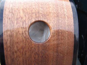

Well, this is kind of a boring photo, but here you go.
rlabbe38450.7245717593

Thanks Roger! What is the diameter of that one? For some reason I was under the impression that they needed to be bigger. If I can make one that small get the same effect that would be great!
Do you like the results? Can you hear it quite a bit better while you are playing?
PostPosted: Fri Apr 08, 2005 8:38 am
Dave I like the report while on the playing side. I made mine 2.50" x 1.5" oval. I made the first circular and the second oval. The oval seems to have a bit more ballance in the tone I have no idea why. I could be imaging it. But it seems to too me

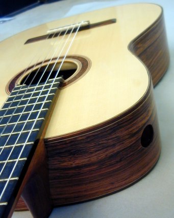

Here's a shot of the guitar I'm building, using the same locations as Kenny Hill does on his classicals:
I think they're one inch diameter (body is only three inches deep at the heel). I have no idea how it will sound, as this is my first guitar. By the way, those holes are for the adjustable bolt-on neck, using Harry Fleishman's system.

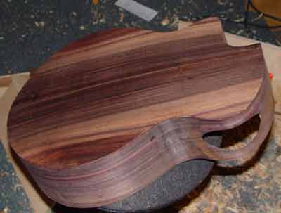

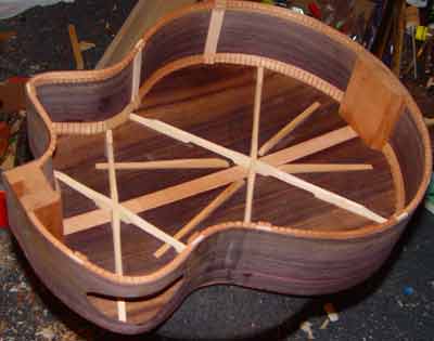

Okay Dave, I finally got a pic of my port. It's a 1 inch diameter hole. This is my first and I strung it up before finishing. I really like the sound with the port; it seems to have a fuller sound. BTW, from looking at some of these pics, I think some of these other guys used the copy of my port template. ;-)

Dave,
I doubled the side at the sound port by using a piece of the same wood except that I rotated the grain 90 degrees.
From my experience, you'll definitely hear the guitar better. I'm sold and will put a port in any guitar that I intend to keep.

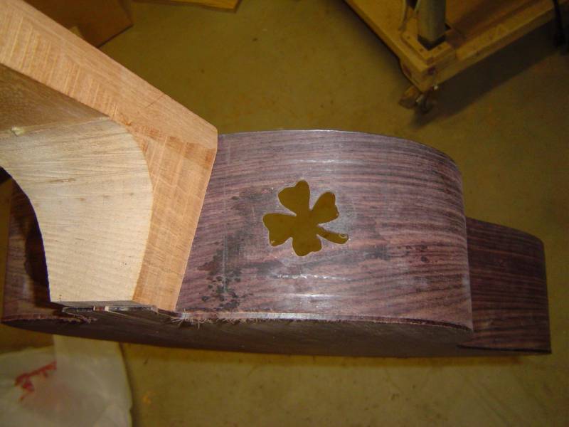

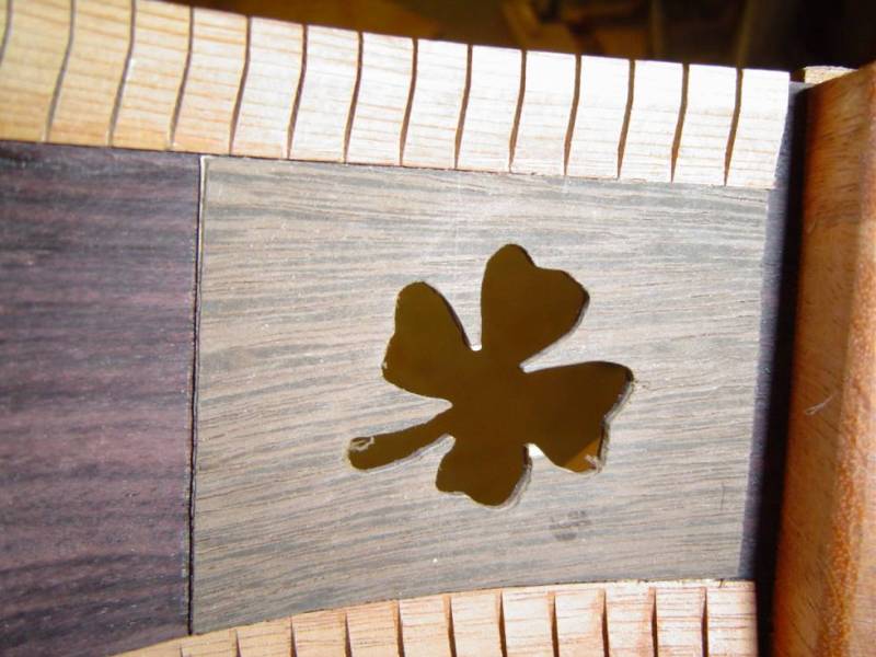

Okay, I figured out how to resize the photos. Here is a soundport I use in some of my classical guitars.

PostPosted: Fri Apr 08, 2005 1:27 pm
Posts: 2358
hahaha, good one Steve! I was just trying to show the Irish roots. I have noticed that the guitar projects much more with the soundport than without it. There is more volume for the audience with the port.
