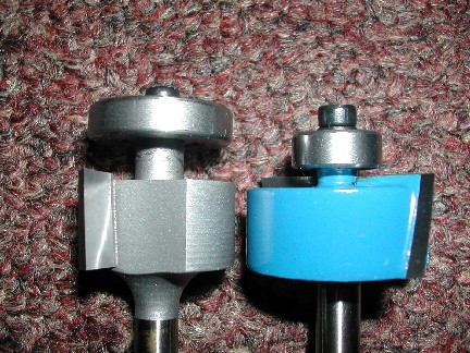

What's the update on the "re-engineering" the binding cutter to have a little more space between cutter and bearing? I remember that discussion, but don't recall haing seen a resolution...
Have you settled on a certain design, if so, can you tell us some specs (IE distance between cutter and bearing, size of cutter, will 1/2" shank be available, can we get em in our favorite color, etc.) Thanks!
PostPosted: Thu Apr 14, 2005 8:48 am
Posts: 688
Thanks Terry! As for the re-engineering of the binding cutter, nothing really happened with that. I spoke to the engineer who designed it, and he thought it would not be a safe product if there was too much of a distance between the cutter and the bearing. I don't know all the mechanics of it, but I trust his judgement. It was decided that you could do 1 of 2 things to correct this. 1. Cut the purfling channels first. 2. Put a small washer under the bearing to raise it up higher. I think the screw is long enough to handle this if the washer is not too thick. As for the 1/2" shank, there are no plans to make this product. If demand was there, of course we would revisit this. I'm in the process of creating a spec sheet on the bit/bearings, I'll have that out on the site soon. Thanks for the interest!

I know that I normally would do the purflings first as Tracy mentioned. "However", I am rebinding my first guitar, the plastic binding is already off. Repair persons may need to occasionally address this too.
I hate to buy an all new set at LMI's prices. I'd like to support Tracy's venture, but I'd only be getting a larger number of bearings, and that's not my problem. (though I will upgrade down the road...)
Without voluminous explanation, or close-up photos that my camera can't do well, my Stew-Mac set doesn't have much "fudge" room for the washer/spacer deal.
From strictly a builder's stand point, I'd invest in the set, making sure I don't do the binding before purflings and get in a pickle.
Hey Tracy, can we revisit this , maybe you can get specs from Terry Kennedy. I haven't heard of any of LMI's sets having problems. I do understand the concern from an engineering standpoint. Let's see what we come up with.... Again, thanks Tracy, you've got a great set there, and I'm really looking forward to seeing you grow as a luthier supplier. VERY COOL.

I know the specs are in the works, Do you have a close-up picture, or can you estimate how much distance I can get with or with out the spacer idea? I realize it may take a while. I'd like to compare with what I have...

Thanks for the encouraging words. I understand your concerns, and I hear you loud and clear. You are in luck, I have both the LMI bit and my bit to compare "zoomed in." I have included a picture of the LMI bit next to my bit. You can clearly see that the distance of the bearing from the top of the cutting blade is a lot higher. In fact, the LMI bit has a clearance of 3/16" from the top of the cutting blade to the bottom of the bearing. Mine has about 1/32". There is a huge difference, and I can see your point that this will be a factor if you do not cut your purfling channel first. However, if you do cut your purfling channel first, then I see no difference between the 2 bits. I will talk to my design guy about this when he gets back from out of town next week. We may be able to do something about this, but it may take some time. I will keep you posted.
Warmest Regards,
PostPosted: Thu Apr 14, 2005 2:29 pm
Posts: 688
The cost now is $144 for the bit and 10 bearings. If you want the whole set of 18, you have to pay $229. Mine you get 19 bearings giving you an extra .25 ledge to cut, when LMI's will only go to .23 ledge cut. Other than that, they are pretty much the same. Oh, and mine is only $155 including shipping. So if you need the extra distance and don't need all of my bearings, then LMI's is a better deal.
Thanks for posting the pictures, it helps to see the product from a different angle.
