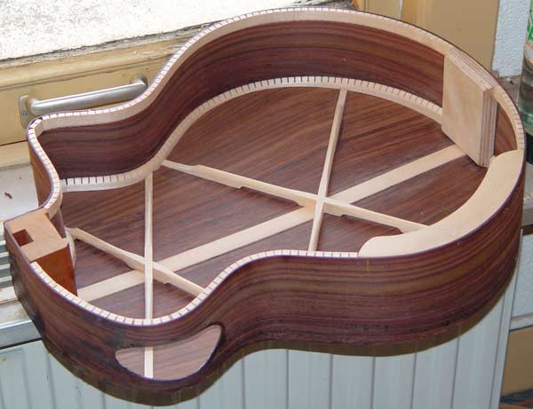

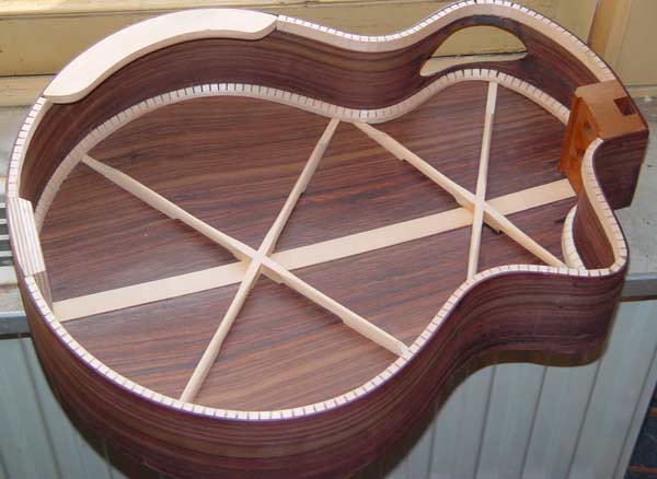

After seeing Tony Karol's step-by-step, and reading an old email I had from Alan Beardsell, I thought it was about time I gave this Laskin armrest thing a try. Here are the results so far. If anyone's interested, I'll post some updates when I get a lid on it...
As you can see, this one also has an auxilliary sound port. In for a penny, in for a pound, as they say!

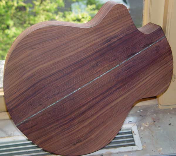

Here's the back, simple paua backstrip with some thin b/w/b purfling. EI rosewood back and sides.

The next step will be to install the top, then I will cut the purfling/binding ledges as normal around most of the guitar, except for the purfling in the armrest area. My armrest will remove 3/4" from the top and the side of the guitar (45 degree bevel).

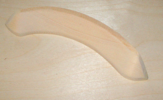

Here is a picture of the armrest support block. I made this one from spruce, but I would imagine cedar or basswood would work equally well. I just happened to have a chunk of spruce laying around.
When you see Tony's notes, you will get a better idea of it. Much simpler in pictures than in words!
