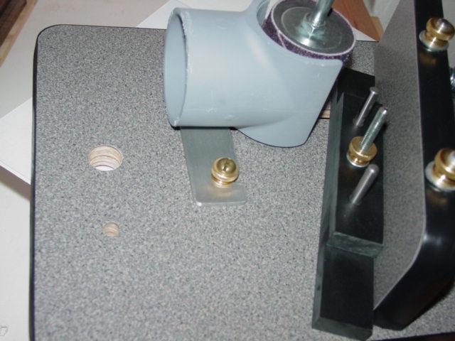

Lance or anyone else with this jig,
I just got my Luthiers Friend/Robo Sander today. Seems pretty neat...one question... what are the two holes on the left side for?
THANKS FOLKS

I have one too, but haven't used it yet. Don't know what the holes are for. Sorry

I just got it, also. I assumed the large one was for bolting it down or hanging it on the wall. The small one is for storing the robo-sander attachment.
I'm actually kind of dissapointed with the sanding drum. It has runout of about 1/16 inch. It seems to be from a combination of a crooked bolt and unround rubber drums. Anyone else have this problem?

Well ,I figured out that two of the three rubber cylinders, the top and the bottom one, were slightly out of round. They were turned so the top one had the high spot on the opposite side than the high spot on the bottom one. This caused the abrasive sleeve to sit skewed. Rearranging the order of the three cylinders and turning the two so the high spots were on the same side solved the problem. Once they were compressed inside the sleeve they trued up.
Ken got back to me right away and offered to send me a new drum and would have called me on his dime if I had given him my phone number correctly
The one thing I'm not real thrilled with is the bottom nut on the drum. The thickness of the table doesn't give much leeway and if not very careful, as I wasn't, the nut or protruding bolt will rub on your drill press table. I think I'll head to the hardware store and see if I can find a better setup for this.
