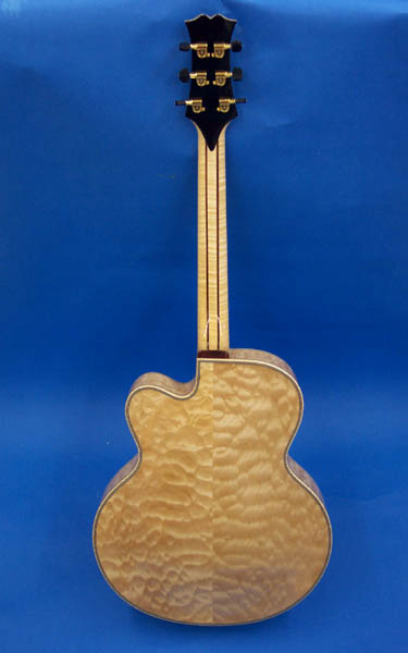

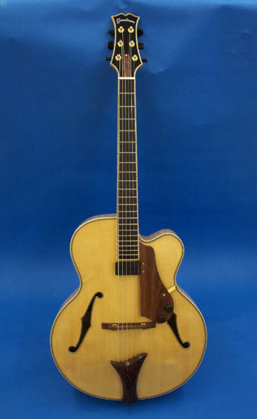

Hi Guys,
Here are some pictures of the last guitar I finished a couple of months ago.
The specs are:Sitka top,quilted maple back and sides,curly hard maple neck,20 year old Honduran rosewood pickguard,tailpiece,heelcap,bridge and neck laminates,ebony headplates and fretboard, 8 line purfling with curly maple binding,Schaller machines w/ebony buttons,Kent Armstrong pickup and nitro finish.

Brad that is one beautiful guitar. Very classy

Brad, that's really nice. I like the maple on maple.
How does it sound?
PostPosted: Sat Apr 30, 2005 11:11 pm
Posts: 2231
Steve, Like most of the guitars i have buit on commission I had it strung up in my shop for 2 weeks before shipping it off so what it sounded like is just a fading memory,but as I remember it had a nice "woody" tone and was quite loud as most of my guitars are.
More importantly it's new owner loves the way it sounds.

Nice design on the tailpiece also. Is that a hinged or Sacconi style?

Wow ! That's pretty. Really nice proportions, and great choices all around.

Brad, it looks great! Just curious, do you use the flat Guild style heel on all of your guitars?

Maple on maple..hmmm...i like. might have to try that one day. great work brad. its always nice for beginners, like me, to see stuff like this. gives me hope and makes me think the pile of scrap wood in the corner may not have died in vain

Real pretty Brad! I too like the maple on maple. Everything works. How about some more closeups?

Nelson, The tailpiece design is neither sacconi type or hinged.What I do is bend a piece of brass(lacquered)at almost a right angle and screw it to the morticed tailpiece. I actually use machine screws and tap the ebony. It's a lot of work but I'm happy with it.

Don,I have carved this style of heel on my archtops for the last bunch but have done the more rounded type as well. I'm still not sure which one I like best.

Brad, Thats a really nice guitar. Maple on maple with a plain fret board, Class.

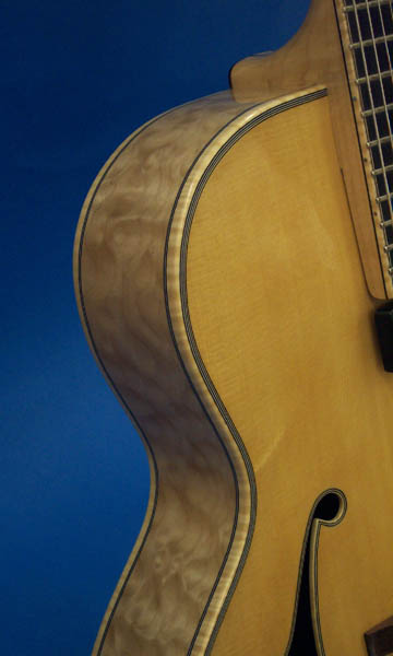

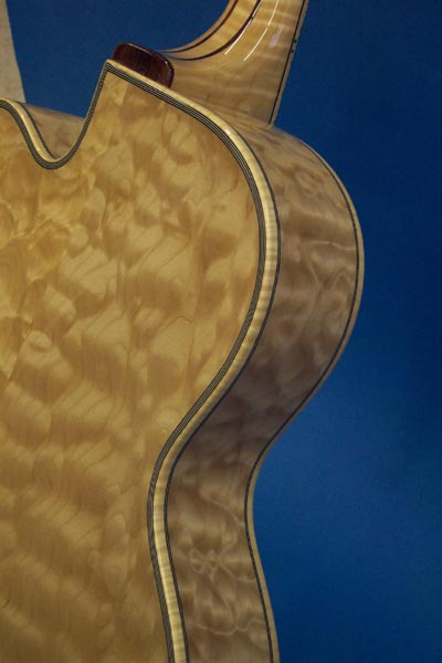

John, I found a few more pictures:
