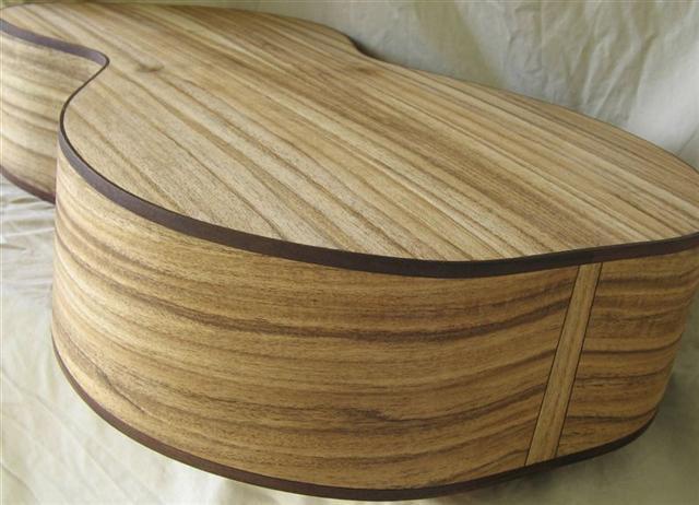

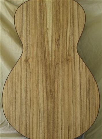

Hey Guys,
Here are a couple of in-progress pics of number three. I was really surprised how this wood changed from dull grays to nice browns with a wash coat of shellac.

Pretty combination. I like how the dark bindings contrast with the variagated striping of the back and sides.
Should come out very nice!!!
Send photos of progress

Nice wood . Is that koa? I`ve got some but I`ve never done anything with it. That wii be a nice looking instrument!
PostPosted: Wed Aug 31, 2005 12:36 pm
Almost looks like pecan??
PostPosted: Wed Aug 31, 2005 4:31 pm
Posts: 697
Is it Myrtlewood?
PostPosted: Wed Aug 31, 2005 5:06 pm
I especially like the end graft. Lovely job!
PostPosted: Wed Aug 31, 2005 5:32 pm
Posts: 267
Location: Brazil
Bruce..very nice job. And I agree with Shane, that end graft is very tastefully done. What wood will you use for the neck ? Walnut maybe ??? Can't wait to see the finished product.

Palo Escrito?
PostPosted: Thu Sep 01, 2005 1:16 am
Posts: 1644
City: Duluth
State: MN
It sure looks like Zebrano (Zebrawood) to me. And it looks great!

my guess is Palo Escrito as well.. nice job
PostPosted: Thu Sep 01, 2005 2:15 am
Nice!
Doesn't look nearly 'rich' and variegated enough for Zebrano to me, though; Zebrano I've got has more darker/golden shades and streaks running through it, even unfinished.
PostPosted: Thu Sep 01, 2005 2:40 am
im betting its PauFerro - nice job by the way!
PostPosted: Thu Sep 01, 2005 7:03 am
Posts: 458
Location: Southern Ohio
Thanks for the compliments, guys. It's South American Laurel. It's a great wood to work with. Bends like butter and very resistant to chipping or splitting. It's light and resonant and reminds me a lot of eastern walnut.
Unfortunately, this one is going to wind up being rather plain looking. I 'm building it to be a work horse. It's mission is to be the guitar that I leave laying around the house so that I can grab it, play as the mood strikes, and not worry about beating it up. As such, I'm just going to leave the pores open and wipe it down with 5 or 6 coats of Tru-Oil. Then again, I may try french polishing it...
I'm also experimenting with an adjustable neck, so I don't want to have too much time invested if (when?) the thing folds up
Jeff - I'm going to use a Honduran mahogany neck. If it's not dark enough, maybe I'll stain it.
