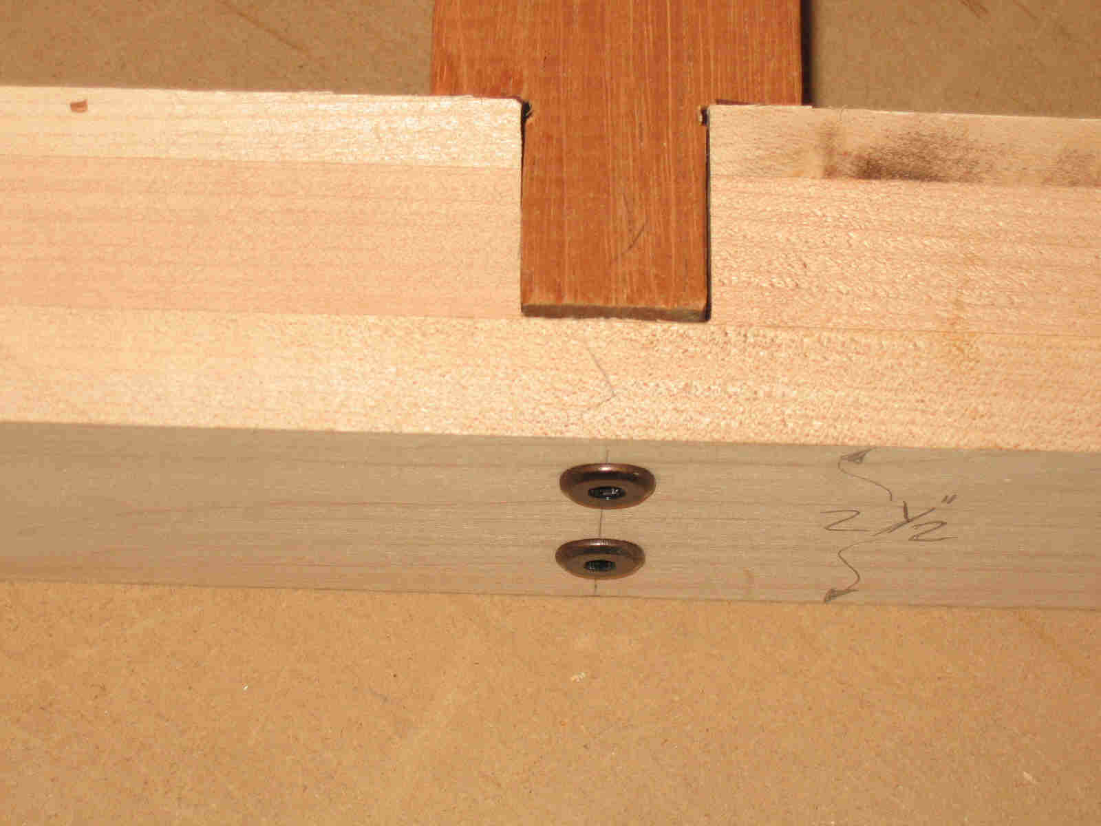

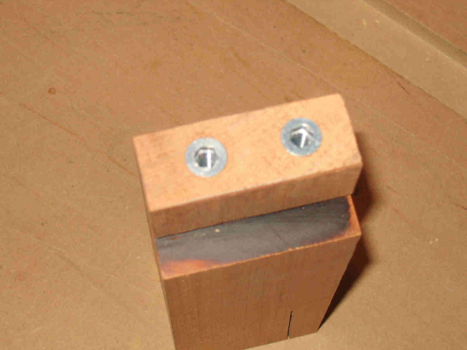

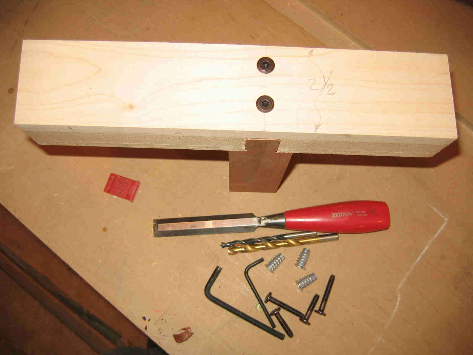

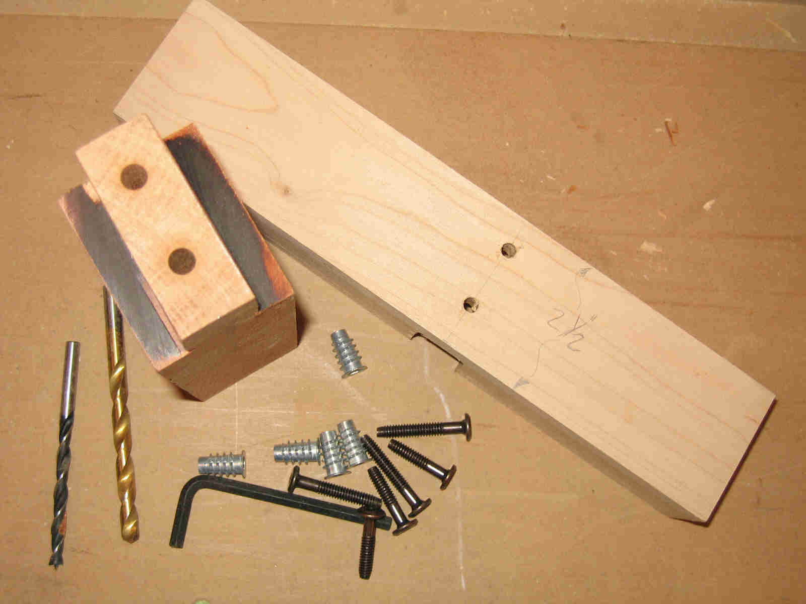

OK Paul, as promised! Sorry for the delay but I spent the day in the shop cutting up some awesome cedar tops!
So the first picture shows the amount of gear needed. In this case I used my drill press but I think I would make a jig by drilling holes through a block of wood for the 1/4 inch bolts but I would find some brass or bronze tube that had a 1/4 inch ID and I would drill for the OD and glue it into the wooden block and I would use that as my drill guide. I hope you understand what I mean. I can't fit the end of a neck under my drill press unless I do some fiddlin'. So I use a 1/4 inch brad point to drill through the neck block and into the tenon at the same time. They will always be lined up then. Then I use a 5/16 normal bit to enlarge the holes in the tenon to accept the inserts. The rest is pretty straight forward and I think the pictures should show it all. Hope this useful.
The picture below shows the inserts installed.
This picture shows the neck and block joined together
And a top view. This was a pretty a crude tenon and of course much better care (a sharper blade, this was done at a friends and not on my uni-saw)would be taken for a guitar neck tenon.
I got to tell you it was very quick and very accurate, even with almost no care in the set up. It might get me rethinking this option over dovetails!
