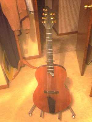

Ok everyone. I've finally finished it. A new Ebony tailpiece and a 0.70 low
A string later and it plays like a champ. I apologize for the really bad
photo. I promise some closeups when I get time this weekend. This was a
quick shot with a cell phone cam. It sounds surprizingly loud despite
there are no f-holes on the top plate. The cedar top gives the archtop the
warm sound I was hoping for. I just have to get used to the wide
fretboard (2 1/8" at the nut) and that 7th string now.
Some quick specs:
25" Scale.
Cedar top plate.
Bubinga neck, sides & back plate.
Ebony fretboard & fittings.
Rubbed Shellac finish (not french polish).
Strings from 0.14 through 0.70.

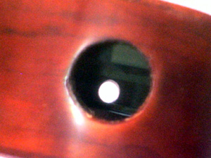

Here is a worm's eye view from one port to the other.
Here is the port on the upper bout.

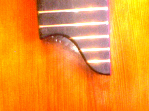

Here is a shot of the fretboard extension.

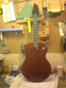

And a shot of the guitar before stringing.
