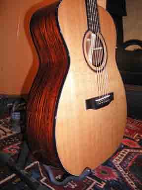

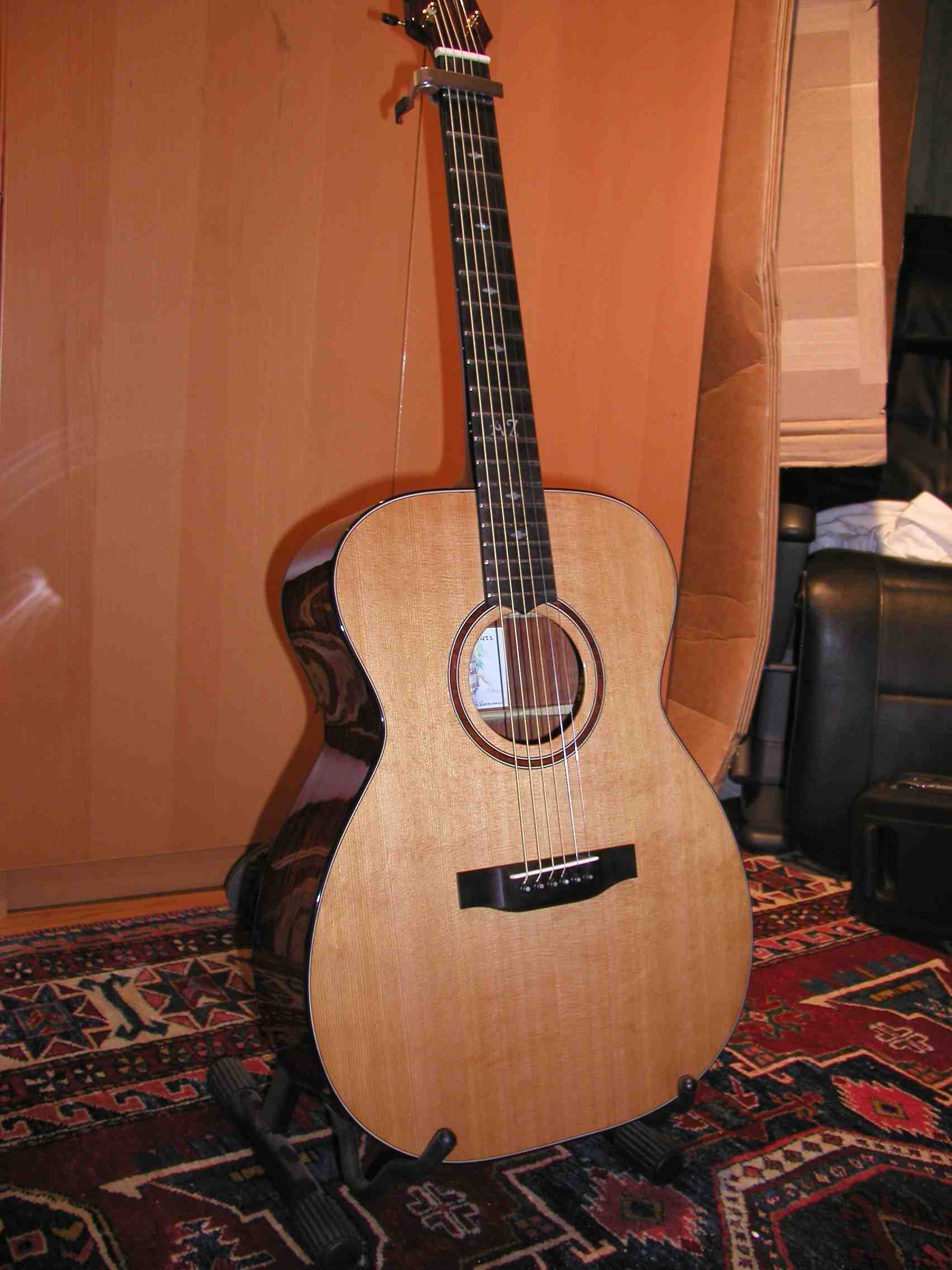

Here is my first guitar from scratch.
000 14 fret
Cedar Top
Cocobolo Back and Sides
Thanks for all Your Help
Andy

Nice! How about a pic of the back?

Fantastic! I;d love to see about 10 more pics! End graph, close up of the rosette, the headstock! You know what we want
PostPosted: Sat Sep 03, 2005 11:58 pm
Great job Andy! I agree with Lance, more pics!!!

Looks really nice Andy. I love the silking in the top and bet it is even prettier in person.

PostPosted: Sun Sep 04, 2005 2:37 am
Thanks for the kind words
I will have to take some more picts.
It sound fine except the B string. I have another thread on this.
It seems to have a slightly muted and buzz on the B string even though the
action is correct and the nut slot seems to be the correct depth.
It is driving me mad.
Andy

Andy,
I'm looking at the photo of your guitar and it is capoed at the first fret. This is a good way to test the buzz problem with the b string. With the capo on at the first fret do you still have the buzz / muting ? If not it is most likely due to a problem with the nut slot. If you still have the buzz, you can probably rule out the nut. Look to the string or the saddle / bridge. Very nice guitar by the way. And I agree, post more photos.Brazilwood38599.5289814815
