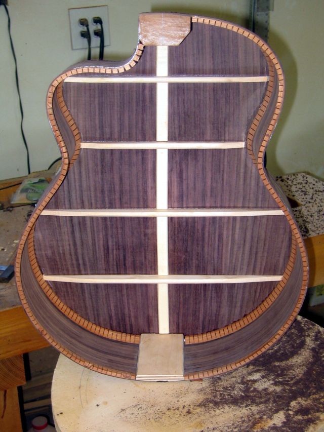

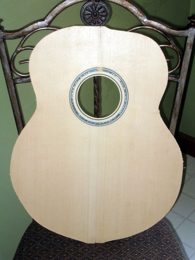

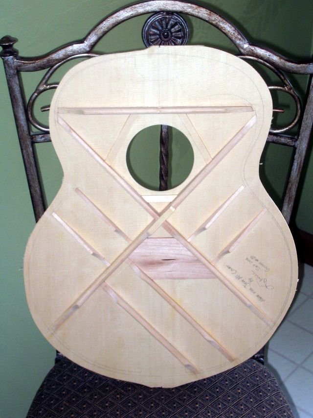

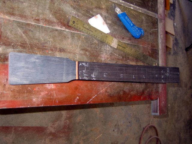

Labor Day weekend seemed a fine time to begin laboring over my small jumbo commission...here's a photo or two...

That's gonna be a beauty Larry. Absolutely wonderful work. Can't wait to
see it finished.

For a second, as the first pic came up, I thought I was looking at the peghead. That chair has a nice shape to it......so does the guitar!

my guess, from the angles of your braces, is that this guy will have a
crisp, balanced, cutting tone. Sweet job Larry!

Terry, the top is at .115 in the middle, thinning just a hair out to the edges south of the soundhole...the bridge plate is 2 5/8" wide (north to south) and pretty much the same size as the plans...when I drew the bridge out on the top the E's looked okay...I sure don't need another surprise at this point tho!
