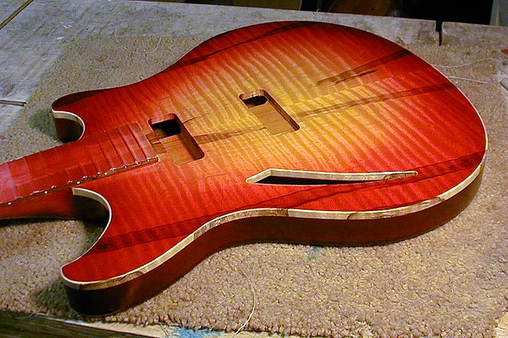

Two-color bursts are bit easier than three, but I found a nice trick for the three-color.
Spray the red on last. Yellow or amber first, then a dark brown or even black. Then use a thin mixture of red, and spray the red over all of the dark brown. Let it go just a bit further into the amber than the brown did, and you don't need much red at all so go real easy with it!
When you spray it on last, it turns the brown or black into a really nice chocolate looking color, and it makes it quite easy to tint the edge into the amber. Part of the key is to keep the red color thin in the mix, you don't need much of the color at all.
Where's the pics, Tim?

Hey Walter, thanks for the comlpiment but the picture above is Mark Swanson's. Here is my feeble attempt at sunbursts.

I like the one on the right the best. I like the shape of that burst....I think that the best bursts are the Gibson ones, if you look at photos you can see how they differ from other makers' bursts. The older J-45 burst is really sweet, many of them have hardly any yellow and the color goes far into the top. Kind of like a old gibson mandolin. For the most part, Gibson always seems to leave a "pear shape" of lighter color in the middle and the upper bouts are always covered in the dark color. If you compare that to an Epiphone burst you can see the difference right away. I think it's kind of funny, since for a time both instruments were made in the same factory but they had different kinds of burst pattern.
Good job, Tim! One othet thing that I find makes it easier to get a smooth and even burst is to make sure the color is mixed a bit thin, so that it takes a few coats to build up to the shade you want. That makes it much simpler to get things nice and even, and a good transition from color to color. It makes it harder to mess up. If you have the color too rich, color will build very fast and it is really easy to mess up.
And when you are spraying a burst, you can't have ANY runs!
