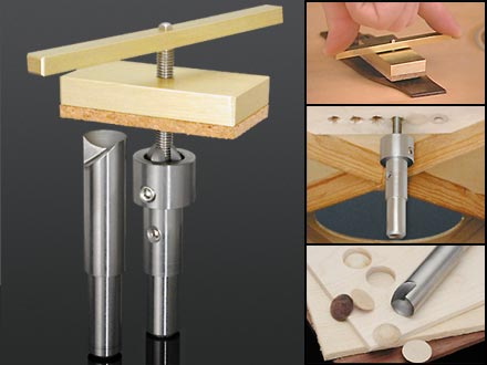

I like the new tool by StewMac, which allows you to repair the bridge patch with tapered plugs. Then you can just cut round plugs of spruce and bridge patch material and you're back at it again.

this is the bridge saver from Stew-mac Don was talking about.
Bridge saver
