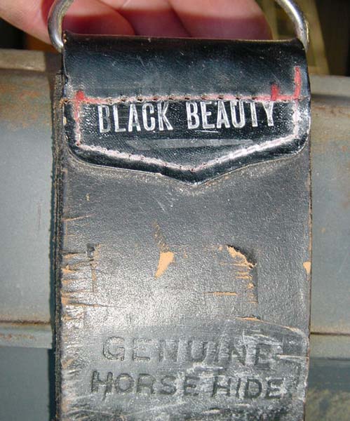

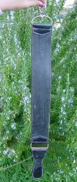

And grab yourself a good leather strop, I got one from a flea market for $20.00au, it's a cracker. NOS from the 50's or 60's as supplied to Mens Barber Shops, it's marked "Genuine Horse Hide" and the brand is "Black Beauty"...am I having you on?? Naaaaaaaaahhhhhhh! Have a look for yourself just like the one Mum used to keep us inline .
Kimlarkim38779.250162037
