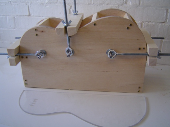

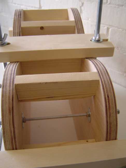

PostPosted: Fri Mar 03, 2006 8:44 pm
I like to keep mine very simple, remembering it's just a shape to bend wood around and keep it that shape until it cools. So I use simple 18mm plywood, good quality but not birch, some 3x2" timber and a few eye bolts. Studding through screw inserts hold the whole thing rigid. I think we can overcomplicate things at times especially for the guy that builds 3 or 4 a year.
